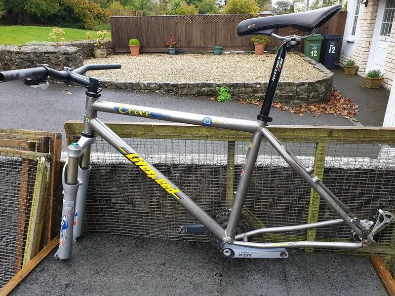

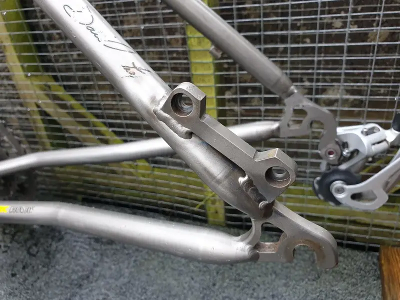

Welded disc mount advice

Yes, it had a 160mm rotor when I got it, which just cleared the stays. But it's more of a 'will the frame be fine' if I run it with discs
I would be cautious. I have a frame hanging up with a snapped rear stay just at the point the disc tab weld stops. This is a frame designed for disc brakes and not a cheap one (trek fuel). That said ive had a disc tab welded to an rts rear stay. Also, many frames don't have the brace between the stays by design.
If you are worried, go with v brakes.
TBH the biggest risk is probably if this has butted stays or not. All the steel ones I've seen that have failed have either had butted stays or been fitted by someone on the agricultural end of metalwork.....
Pretty sure a 23 year old Ti frame will just have straight gauge stays. In a stock, off the shelf configuration. So unless you're going to be doing trials or hardcore/racing, you'll probably be ok.
