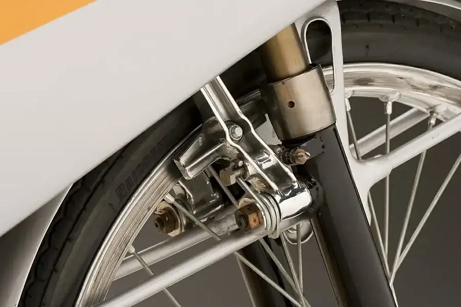

In 1965 Honda were actively contesting the 50cc Motorcycle World Championship . Their entry
was a novel 50cc twin cylinder, double overhead cam , 4 stroke motorbike with many unique features
Known as the Honda RC116 , as part of a weight saving measure they discarded conventional hub brakes ,
and instead fitted a linear pull cable operated brake ( now known as a V - Brake ! ) behind the lower fork legs
The parallel brake arms were secured to brake pivots brazed to the forks and extending either side of the
rim/tyre/mudguard were connected together by the operating cable ( like a V - Brake ) and routed around to the
RH brake lever . The brake pads were positioned to operate on the rim sidewalls . The brake arms were
placed at the rear of the forks for aerodynamic reasons

I'm adding pictures to safe others a bit time
Those look indeed like V-Brakes.

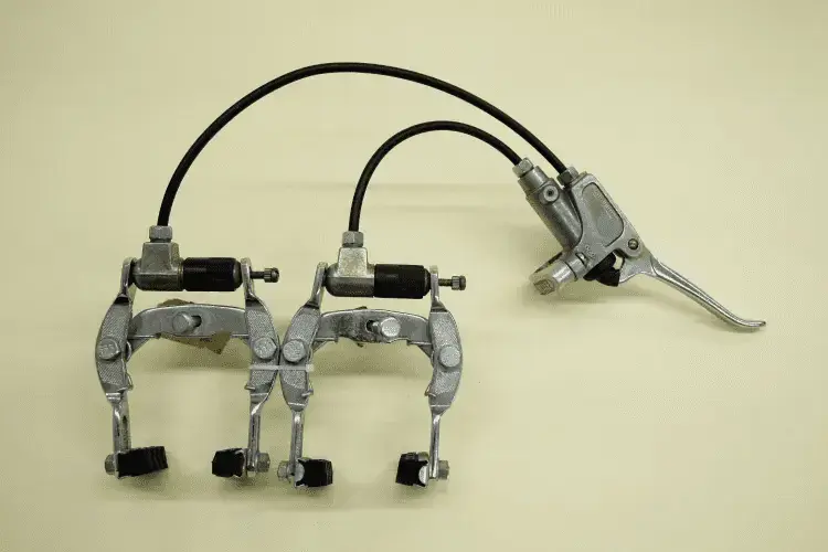

Florian Wiesmann, to me one of the key guys introducing the V-Brake, is also commenting e.g. at oldschoolracing that
similar brakes had been used for Mopeds earlier
Edit: I've added a link using Google translator, hopefully this works
It's an intresting read, in the section towards the bottom he is mentioning Mopeds, the Bontrager one, Gebla homemade V-Brakes and finally his Wie-Brake.
According to some legends, Shimano thought "Wie" stands for the letter "V" as this is pronounced similar and that should be the reason why Shimano called their variant then "V-brake"🤨

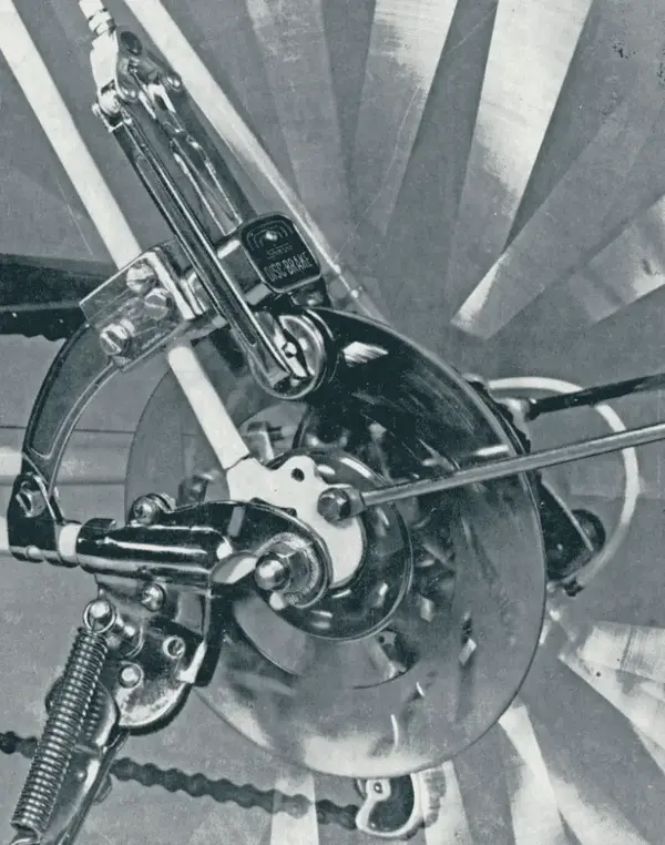

Still can’t find any French ‘V’s, but this unbelievably advanced bike from 1937 has a much more complex version of the theme:
That's saucy 👍
