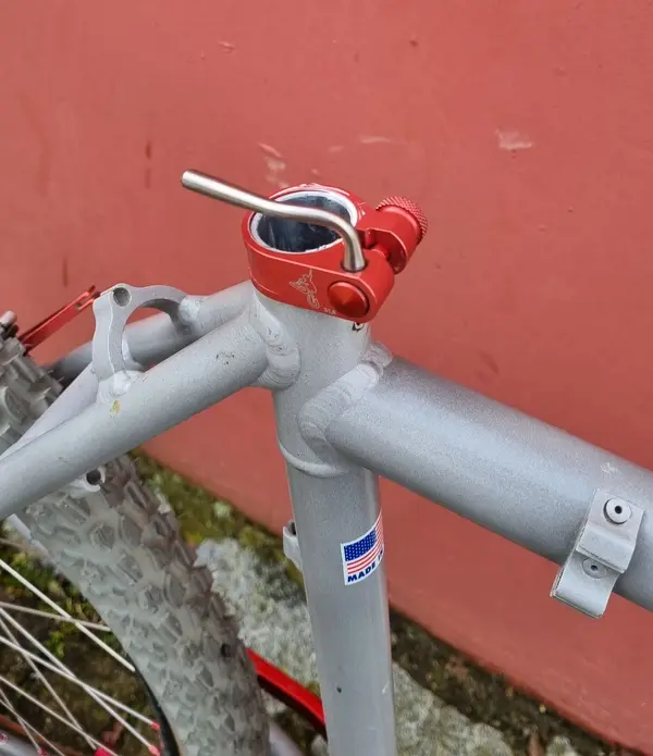

What size seat clamp do I need for this frame? And is there anything else I should consider while looking for a seat clamp?
Hi, I do have a Tune Würger clamp in size 31.8mm which fits pretty nicely
Indeed the seat post is with 26.6mm an uncommon size.

Thank you for confirming the clamp size. I have had a few 26.6 mm posts and I still have a very nice Tioga one. I tested it and it felt like there was a little more movement than I expected, but a 26.8 was too tight. 26.7 do exist! I had one on a Fisher. They are too rare though and finding a decent one would be nigh on impossible. I can use the Tioga one as a stand in, but it doesn't really feel like it fits with the direction this build is going.

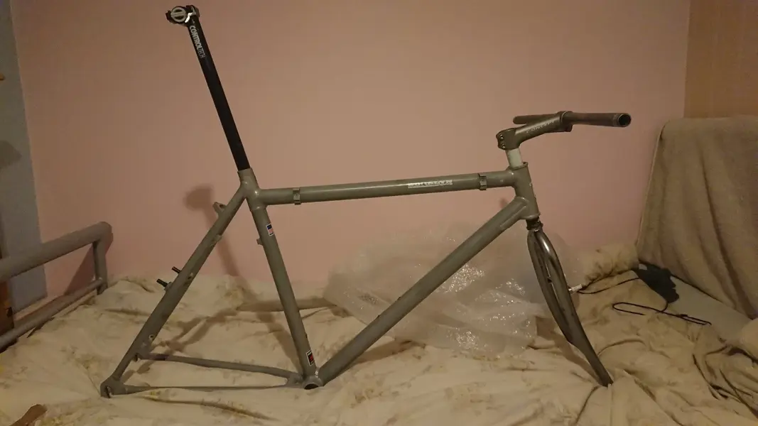

No luck in finding any bouncy fork for this, but some progress nonetheless. I now have a very nice rigid Spinner fork to build it up with until I find a suspension fork I like.
Low stack headset is on the way and huge thanks to @carlhcyc for the karma seatpost, which is perfect for what will be a mainly USA build:
I'll need to pick up the wheels and dig the chainset out of storage. Hopefully I have a bottom bracket, then I will just need to think about the remaining decisions.
