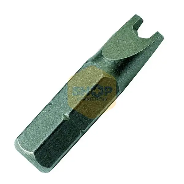

Unlikely to work as the top of the spoke protrudes through the end of the nipple. There is a tool that you can use, bu66ered if i can remember what its called(but I'll take a google now, see if i can find an example)
Found it. Called a two pin security bit, also a snake eye bit.
Now I've not used this, but i saw one a few months ago and thought it might do for such an application. I think you may have to file it a bit thinner, but I dont know, as said never actually used one.
