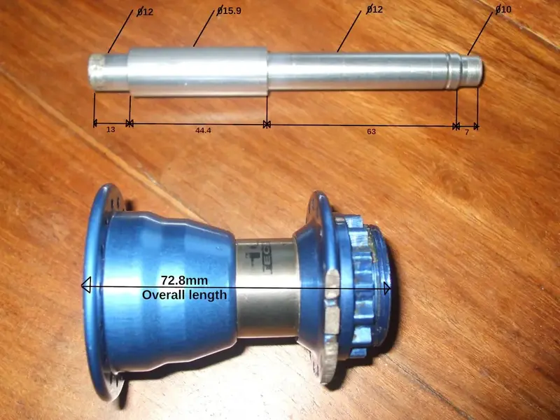

Well my new cassette tool arrived today as I can't find my original, anyway I've finally been able to strip the hub and take a bunch of measurements to compare with other Ti Glide hub bodies.
I'm hoping the important dimension which is the space between the pair of 6001 bearings that support the hub body is the same on other Ti Glide axles as it is on my axle (44.4mm).

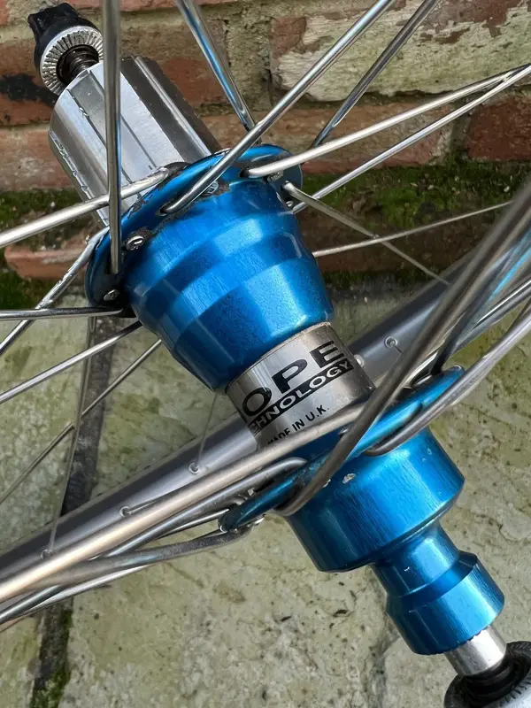

I’d have thought the bodies of the disc and non-disc versions are the same. Unfortunately I don’t have a non disc one to hand to strip and measure though. Here’s a pic if it helps for now.
The 44.4mm is the same on xc, sport and bulb.
You need another castellated hub or a later 6 bolt XC which is similar in dimension to the Ti Glide
