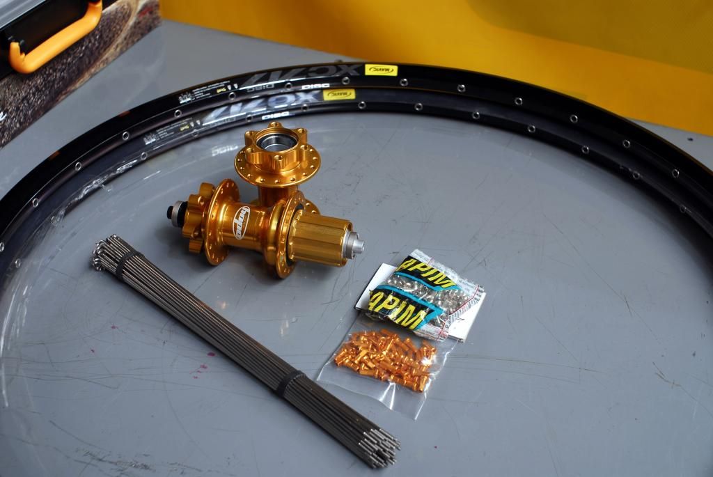

The last of the components arrived this week for the new wheels, got around to building them today.
Not fitted to the bike yet, I am going ten speed at the same time and those parts have started to arrive too.
