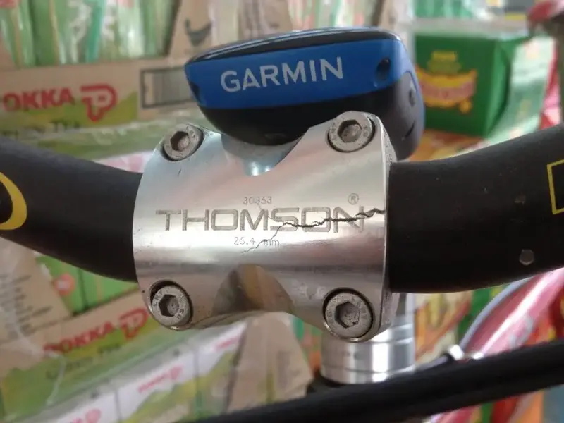

I've ran a few Thomson parts over the years, but recently I've had a cracked seatpost and a cracked stem. Anyone had this on here?

I've also bought a stem with a cracked face plate which I wasn't aware of, can't find a replacement anywhere.

They used to have a high incidence of cracked faceplates and would replace them if asked.
I don't think they'll do it for 25.4mm versions though as they don't make them anymore. You can still find new replacement faceplates for 31.8mm bars.
This one is sitting waiting for the day when a wrecked stem with an unharmed faceplate appears . . .

Yes I have.🤕
Both cracked.☹️

Apparently the seatpost issue is/was due to differential thermal expansion (if you have left your bike in the shed, difference between daytime and nightly temperatures). Which leads to a kind of (I guess you could say thermal) fatigue cracking.

Forging is stronger than machining (in terms of fatigue).
So I emailed Thomson and got this reply
We generally advise that components be replaced every 3-5 yrs based on usage as all metal is subject to fatigue, especially those with clamping pressure applied. Thermal expansion through the seasons and while in storage also affects the material (non climate controlled storage).
As the component is outside of the warranty time frame, I can only offer you a 50% discount off a replacement part (same model) through our webstore. We would just need you to send in the old part along with a copy of this email chain. Once received, the coupon code would be emailed to you. Coupons can not be used on clearance/refurbished items.
These stems are £70 and you're expected to change them 3-5 years! WHAT A JOKE
