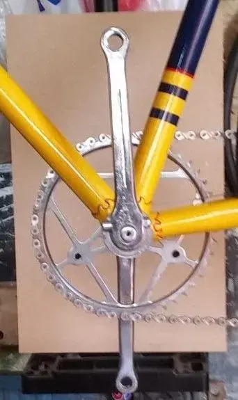

Beautlfully built wheels back from my LBS at last. Reassembly beginning. It's starting to look a bit more like a bike again :D I'd really like some amber wall tyres to complete the look but that will have to wait...

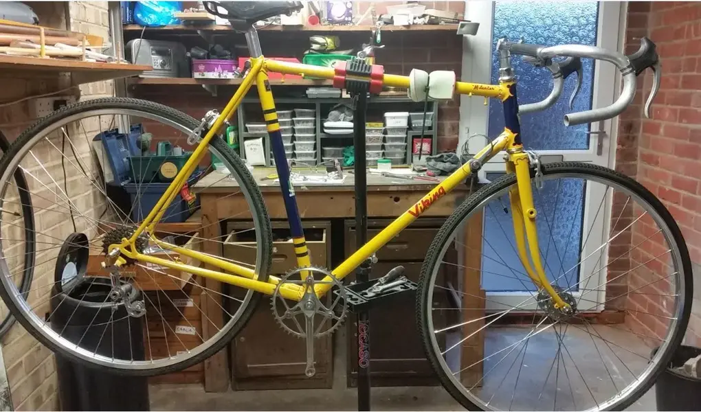

Took the bike to my LBS for proper fixing of the cottered cranks - I've filed and bashed too many cotter pins over the years and wanted it done properly. Collected yesterday. Put the bike back in the work stand today to set up the brakes etc. Can anyone spot the deliberate mistake :facepalm:
And this is a guy with about 40 years in the business. Not in the business of replacing cottered cranks obviously. I said early on that "there may be tears" during this rebuild. This time I don't know whether to hoot with laughter or cry uncontrollably.

Re: The Viking Saga
Oh dear.. :facepalm:
