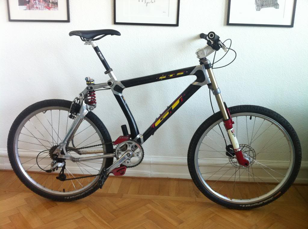

Hello all!

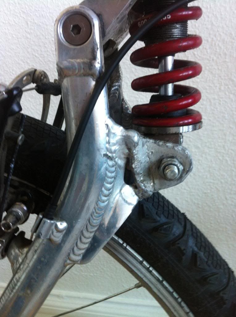

New to this site, just got me a Gary Turner STS DH time machine.
No broken carbon/poly but the rear frame have been welded, so it has probably been down a slope or two.
Just got it through the front door, so it's time for a real cleanup. Need new decals and a bash guard thou :-/
