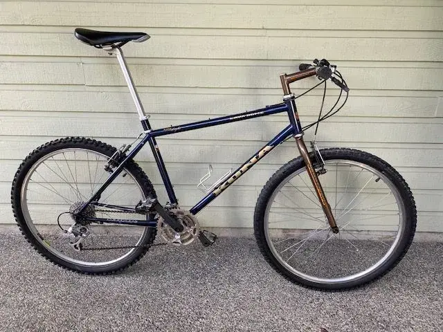

Nice find, I have it's identical twin, same year, same colour, same size and also all original, including the same tires. I've done a few upgrades including Arch Rivals, Will post a pic.
