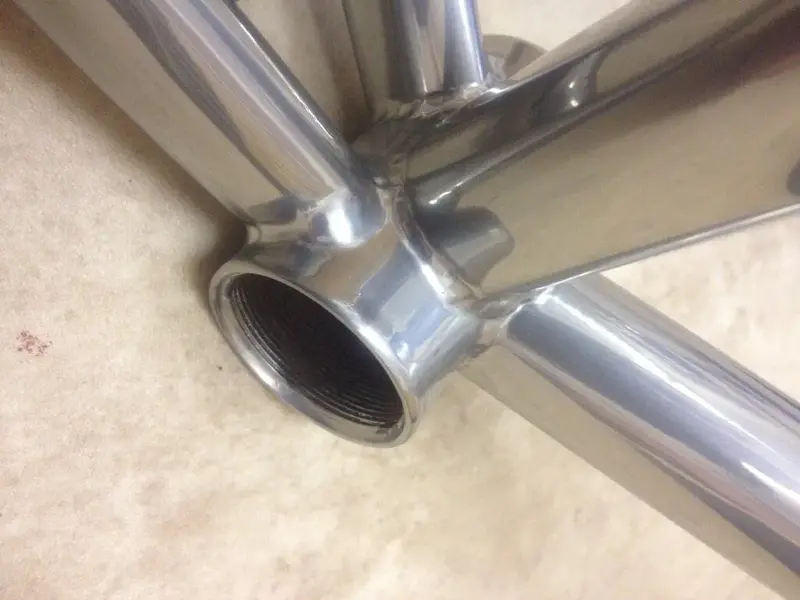

Little bit of random progress....

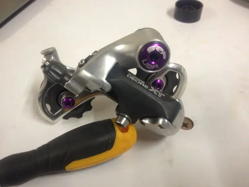

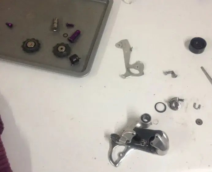

Took the U'Hu out for a ride on Sunday, generally ok but had some issues with the rear mech :facepalm:. When looking down at it from above the cage looked twisted and I was having some issues with it shifting. Once i got back I stripped it down and had a close look... to mech seemed fine. on closer inspection the mech hanger was slightly bent! :? so a bit of gentle leverage with the adjustables has hopefully done the trick. Will have to wait for the next ride to find out.

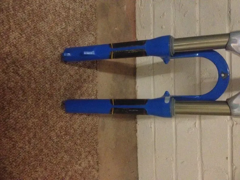

On the other projects: the SIDs... I was naughty and I've bought another set but 1998 ish rather than 99. so lets hope this set turns out to be good. I will still try to repair the 99's but parts are somewhat elusive!

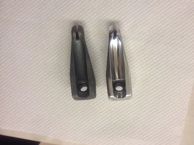

I started to clean up some of the parts for the 94 Kilauea, polished up the Kona cable stop...

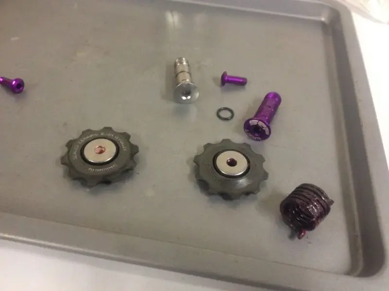

And I've added some purple to the rear mech :p ...

well been a little while, Christmas is gone and January is here... will it ever stop raining?

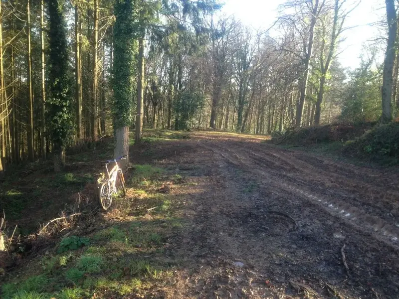

Took the U'Hu for a spin again, mostly on the road, but still managed to find some trails that were very squidgy where they'd been pulped by the horse riders .... who needs brakes! :LOL: but it was lovely and quiet!

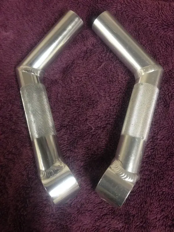

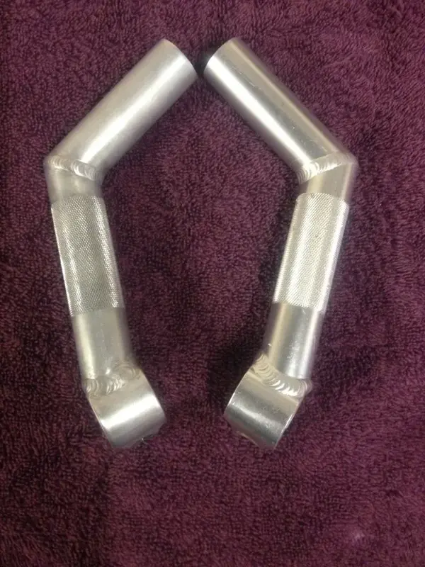

Also spent a little while in the garage with the wet n dry polishing up some Control Tech bar ends.... (one on the right is untouched)
after sanding with various grades of wet n dry 240, 400, 800, 1200 & 2500
and after some autosol :cool:

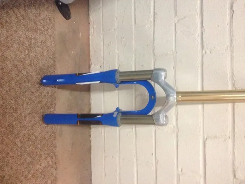

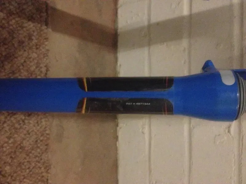

The 98 SIDs arrived and all appears good with them, although I haven't stripped them yet.... :?: not sure I want to! But I did tidy up the peeling stickers with a clean and some sticky back plastic :mrgreen: Blue Peter Style!
Before
After
Hopefully this will keep it tidy.

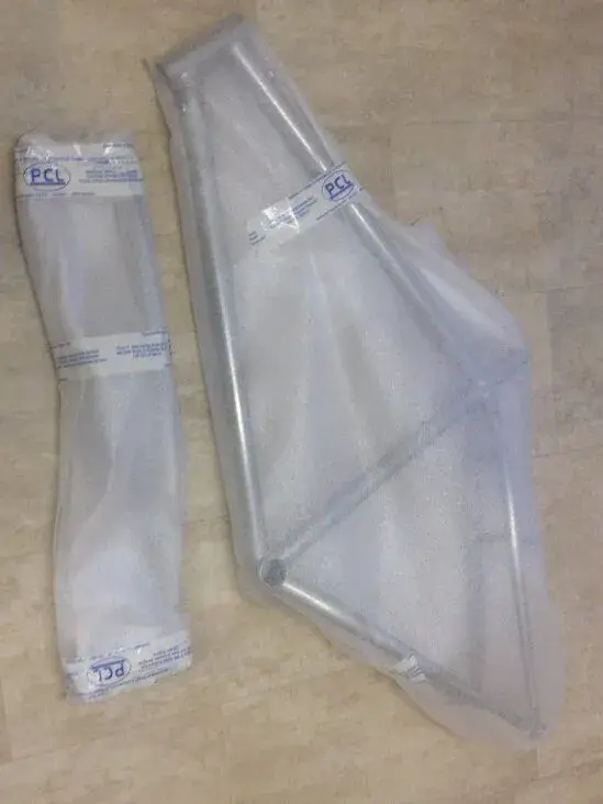

Yes I agree, I do like the look of yours! So today I took the 94 frame, P2's and velocity stem off down to PCL in Bridgwater (about 3 miles from me) and I'm having the frame done in a light gloss Silver, and the stem/forks done in a gloss Anthracite. Hopefully will only be about a week.

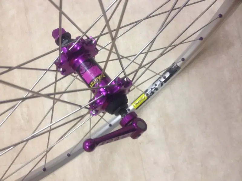

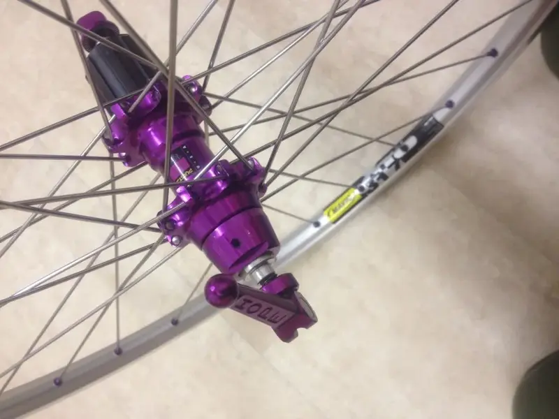

In the meantime I've had my wheels built by SJS (just round the corner :D ) that was not a smooth process.
I originally went in with my set of NOS Pulstar hubs and they quoted me for a build. but due to having to order in the direct pull spokes it was ridiculous.
So after some ebay searching I found some Phil Wood spokes in the states that I could buy in various lengths in small batches (18 a time). So I happily ordered some up. When they arrived, off I trotted to SJS with the hubs and spokes to the length their wheelbuilder had quoted.
A couple of days later came the call.... the spokes are too short! the ebay seller had measured them differently to the wheelbuilder :facepalm: :facepalm: .
So off to ebay again and ordered up some longer ones. When they arrived dropped them off and a day later picked these up.. :D
They ain't the lightest wheels but I like them! Spec as follow:
Pulstar Hubs, Phil Wood plain gauge spokes, DT alloy nips, Mavic XM317 rims, Hope QR skewers & Tioga Pyscho Tyres.....front = 1765g Rear = 1975g (no cassette)

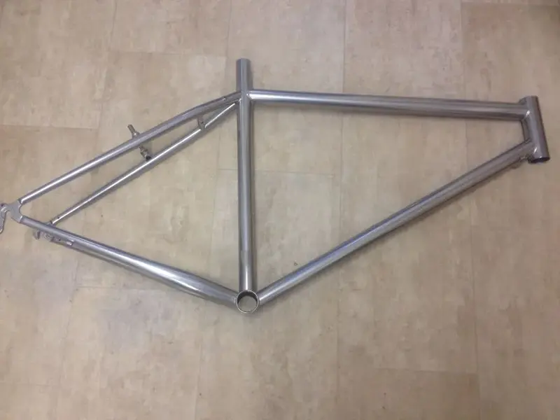

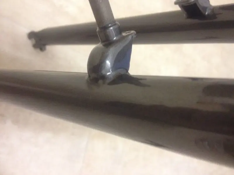

Collected the frame and forks from PCL powder coating in Bridgwater today. The finish is very good, just a few imperfections, but a lovely shiny gloss!
now just got to tidy up some of the masking edges and chase the threads, and it will be time to apply the decals :D :D
