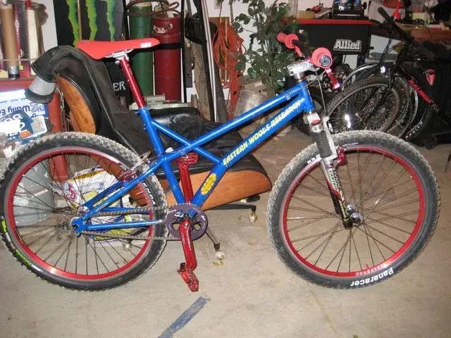

The Tatty EWR has emerged on MTBR from it's recent buildup compliments of the new owner. Not too bad for $315. Looks like a fun bike, although when I had a Manitou 4 on mine, I found that the fork was too floppy to be of much use, and I would imagine the EFC would suffer the same way. I'm betting also that the rider changes the stem length in favor of one a little longer...between the stubby stem and the jacked up straight post, he's going to feel bunched...unless of course he's got crazy long legs and a short torso. Get that Ringle crap off of there! :LOL:
SDG seat...he's got class.
He even kept the West Virginia Mountain Bike Festival sticker. Bad Ass... :cool:

Nice to see it resurrected......build is a little pimpy for a bike like this but hey, it's not my bike...
Im a little more concerned about leaning a bike against that Eames chair :?
nice Caramba's though - but I agree with Neill, its a bit over-pimped for a proper 'rider'
A little red goes a long way, for sure, but I'm excited to see it built, and to see that it hasn't been repainted. :D
Needs dirt. :cool:
Agree with all the comments, glad to se it wasn't painted too :cool:
