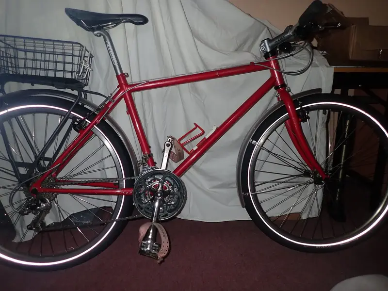

Pretty much any old mtb will do the job, it could be argued that aluminium may have the edge in that it's a little bit lighter and not prone to rust, but if the bike is specifically for the purpose of riding during the winter and in bad weather then you can treat steel frames internally and care for them externally to drastically reduce the effects of water.
This is my winter/bad weather commuter, it's an old MF Monarch Pro, light as a feather and a lovely compliant and comfy ride, the only changes I may make to it for next year will be to upgrade the group from STX to DX for the added durability.
It's a fun bike to ride too, is happy on or off the tarmac, can switch the tyres for something a bit grippier if and when the snow comes, and more importantly my more valuable or treasured bikes are spared the wear and tear that British winter riding inevitably inflicts. Personally not worried about enclosed chains or hub gears etc, this is easy to maintain and replacement parts are cheap as chips
