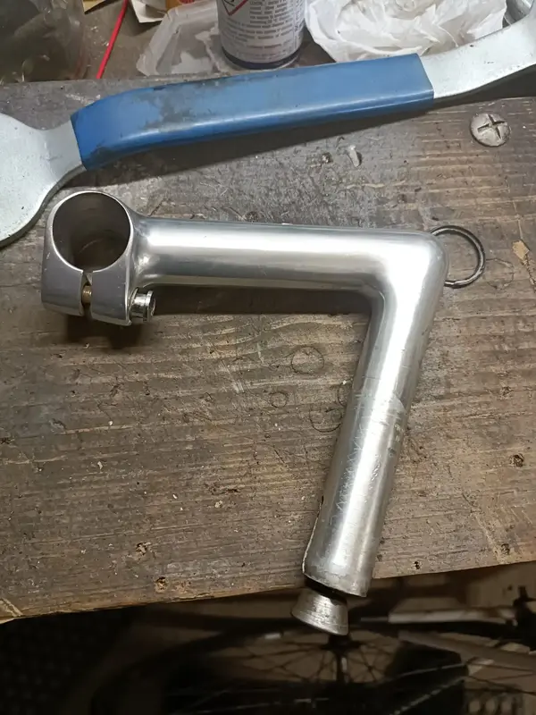

Success!
I think those Cinelli bungs are maybe a bit too good. It had been tightened so much that it had deformed the fork tube.
I got it out by getting a thin drift past the (detached) bung and hitting the bottom of the stem from below (lots of blows, alternating the impact point).
I can't get the bottom cup or crown race past the deformity in the fort tube so I'll need to do a bit of frame rolling maybe.

That used to be quite common. Back in the day there were no recommended torque settings for things so people had no idea how tight things should be. My technique was to tighten a stem until I could only *just* move it by turning the handlebars with the front wheel gripped between my legs.
