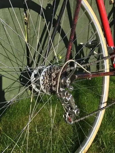

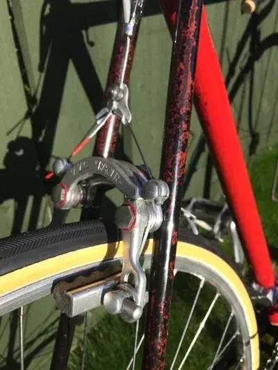

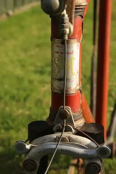

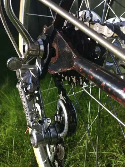

Well I have been working hard. Or should I say having fun. The bike is in its final stage of build. I haven't ridden it yet. Just put the bar tape on. Its once again a rare Sid Mottram ready for the road.
As you know its my first retro build. It is not what I expected. I wanted to do it on the cheap , but so far spend short of £1,000. That includes everything including petrol and parts bought twice, tools, tannic acid and Rustin that i did not use. The technical stuff: The wheel are Airlight, on Fiamme sprint rims, Rally Vittoria tubs. The Chainset is an 80s Stronglight (I know its no period.) The pedals are French. The rear mech in a Campagnolo Gran Sport, and front mech is a Campagnolo Valentino, with Campy twin shifters. A new Brooks Swift saddle and Brooks leather bar tape. The brakes are Mafac Racer circa 1950s. Headset is a Brampton and bottom bracket cups are Bayliss and Wiley. It has alloy flint catchers and a St Christopher for luck.
I treated the rust with CLR bought from Screwfix for £6 and it does not mark the paint (keeping it off the transfers). I clear coated with two pack acrylic paint over the finish and this has protected the very thin paint in a way my original idea of wax oil would not have done. It is now silky smooth. I wanted to keep the old patina, because anyone can repaint a frame. I have several. The aged marks were hard won. I was worried the lacquer would not adhear to the surface, but there are no problems.
I found the bike jumbles at Preston and Manchester the best place for bits. I bought some ebay stuff, but the prices there can go nuts. It is not concours standard. Nor its it strictly period. The more you do, the more you learn.
These are the before and after pictures

Wow! Impressive work, gotta love those handlebars and cranks - rBotM contender ;)
Really like the finish on the frame too!
Thanks for sharing and enjoy the ride :)

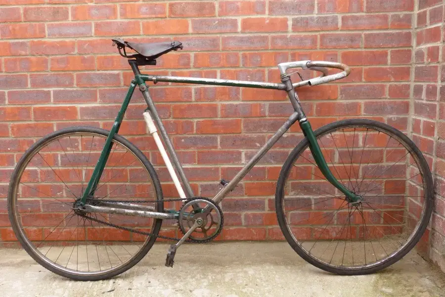

Sorry, but I have to ask: do you still have the old cranks and pedals? Any plans for them? They would really finish of my pre-war pathracer build (based on a sloping top tube New Hudson - see attached pic)

Dear Creign design, thanks for your comments. the handlebars are special, but the crank is ott for rBotm. I chose it because it always wanted one and could not find a cheap double. I put gears on it for the Eroica ride. I will be turning it back to fixed when I have finished that. I some times run out with the Hull Fixi Club. they are mad, but they love bikes. there is no VCC in Hull as far as I am aware. I ride with Hull Thursday.I will put the crank back on it. at the last cycle jumble I went to there was a guy with a box of Williams chain rings and cranks . You would get one for £15£25. You are right it would look good on your new Hudson. I love that bike. I wanted something early like that, but you don't see them. I have a picture on my Facebook site of Hull Thursday Riders in 1904 on similar machines. It's the sloping headset that gets me, and those bars, well brilliant.
