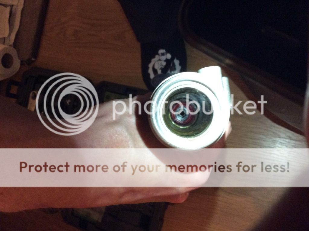

1. I've stripped them tonight, but the white (yellow) washer/bush thing from atop the oil damper was flipped on its side (semi-stuck) when I inspected inside the leg, so I had to pull it out to clean it and make sure it goes back in the right way up, but should it have even come out from the top of the leg in the first place?
2. Inside the dummy leg, there's a red washer/seal - should it be there? What's it for and should i attempt to remove it?
3. The oil damper is "whooshing" like I presume it should but sometimes I get 5 or 6mm of slack/movement before the rod seems to engage the damper - is this normal/okay/buggered?
I don't really want to remove the damper (lack of special tools) but will properly grease up everything before it all goes back together and will fit a new set of dust/wiper seals too.
Thanks in advance.
Pics to assist:
Which seals, new style ones don't for.
A gap in the damper means no oil, you need more in.
This but a scratch on the stanchion, it makes it less smooth and check the bushing.

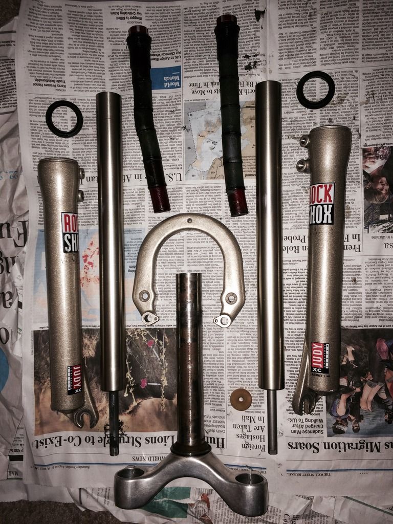

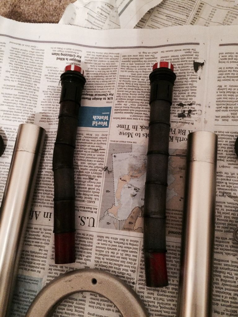

More help needed please guys...

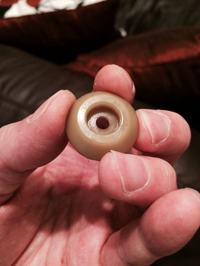

I've been poring over GT-Steve's Judy rebuild thread but I have a problem in the fact my internals seem to be missing some bushes/washers. And I have an extra black bush/washer that I think goes on top of the damper shaft (it fits and the yellowish dished washer will sit it the top of it) but there's only one and the whole damper shaft length would be longer than the dummy if I fit it!??!?! And I can't see anything on Steve's rebuild that looks similar.
I have 2 sets of Judys so I've stripped the damper leg on the spare set to check but the black mystery bush/washer is stuck inside the stanchion with the dished yellow one!
How the feck do these go back together? Do I need the black bit?
Pulling my hair out atm :'(
That black bit isn't for the damper if memory serves, it sits inside the top adjuster and you fit a spring inside it. The white bit fits on the damper shaft and the spring or elastomer sits on that when all put together. Hope that makes sense.
