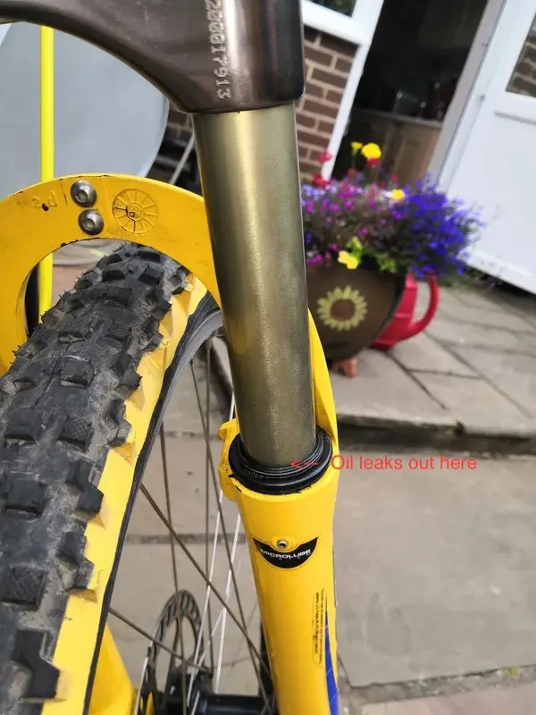

I picked up a '99 Marin Rift Zone from a cousin earlier this year. It was "okay", but needed some new parts and a lot of TLC. I got it sorted reasonably well, but I took it out recently and it had a bit of fluid leaking through the right-hand wiper seal. I reached out to a number of local Surrey mountain bike outlets requesting a fork service, but as they are so old, the majority declined to assist.

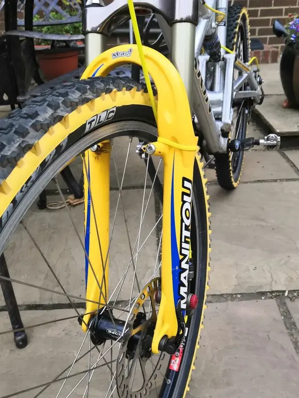

De-gassed the air from the left leg. Removed the 4mm allen key and 8mm allan key bolts from the lower legs. Lost all the fork fluid and damper fluid, but I have replacement bottles of these already.
The outer legs then slide, but they won't slide off the inner legs. They appear to hit an internal stop, which I am not going to force.

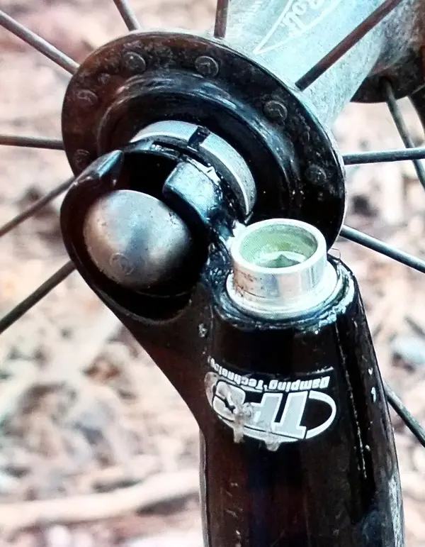

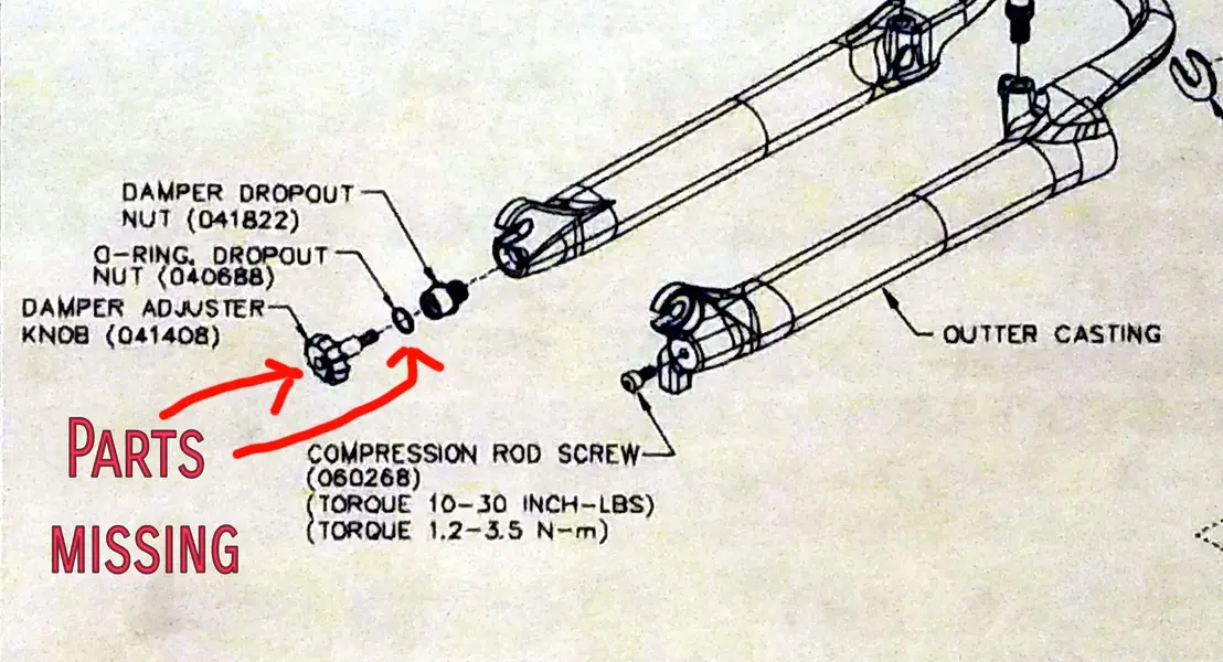

I have a manitou sx-r fork which requires service after the damping adjustment knob popped off somewhere on the Bracknell forest Red trail a few days ago. All the damping fluid/oil has gone.
You mentioned in your post that you reached out to a number of cycle shops in Surrey for a fork service but most refused the job. Could you tell me which shops said they would try to fix them? I don't have any rebuilding experience so would rather take it to a pro.

With most forks I've worked on (mostly rockshox or fox old and new), there is a taper inside the leg that the damping rod sits in. You need to break the hold the taper has. On rockshox and fox, it is a case of using the bolts that you've probably removed from yours, scree them back in a fair bit, leaving some room so that when you hit with a rubber mallet, the damper rod will be forced out if the taper. I tend to be using a long Allen key (t handle) so use the mallet on this rather than directly on the bolt. Repeat on both sides.
Hope this makes sense. May not apply to manitou, I've not worked on anything newer than a manitou 4.
