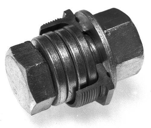

Sheldon Brown has a good way of using a bolt and washers to free a stuck fixed cup.
http://sheldonbrown.com/tooltips/bbcups.html
