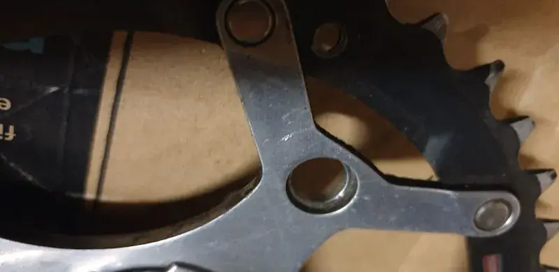

A have already seen someone cutting most of the outer ring off, leaving the holes for middle chainring there, and using a NW chainring attached to the four holes. Just something to consider, might be a cheap way to bring the cranks back to use. Haven't tried myself, but one day... As I also have the crankset with worn chainrings .)

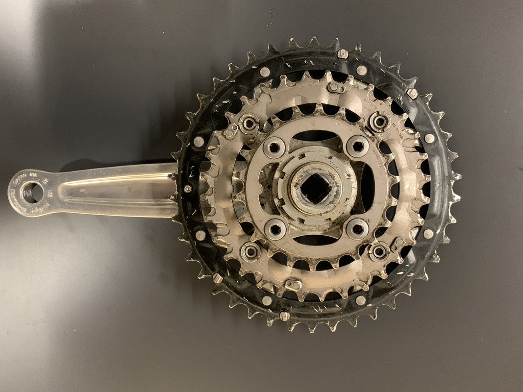

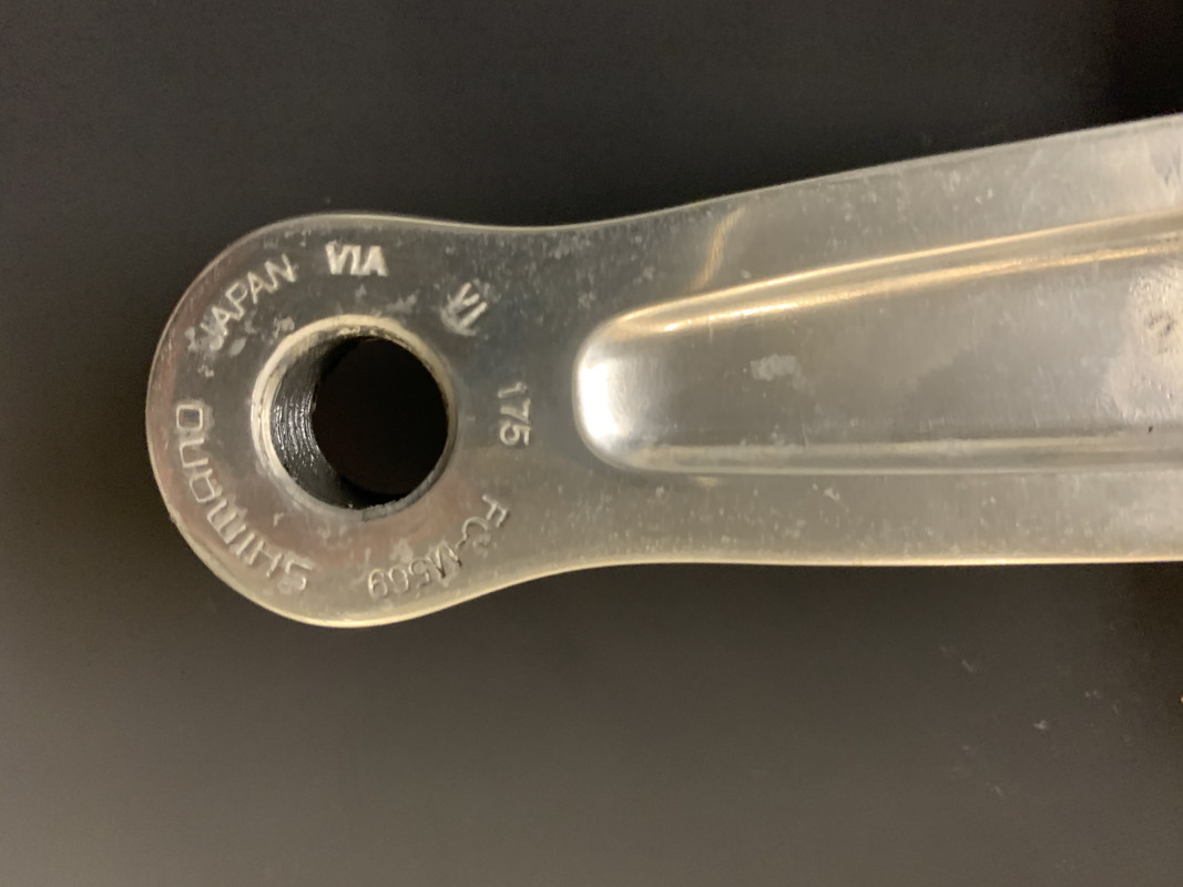

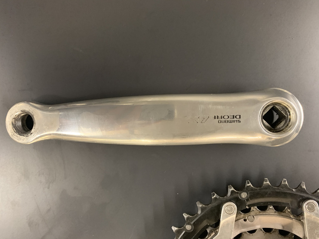

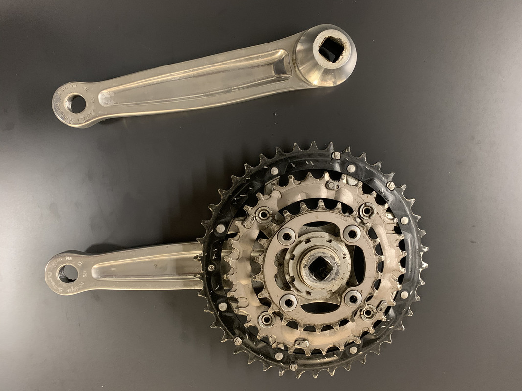

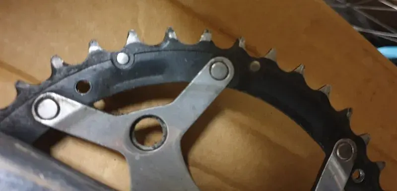

Here's the one I have. Teeth look OK but pics tell a thousand words.

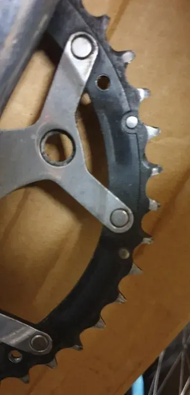

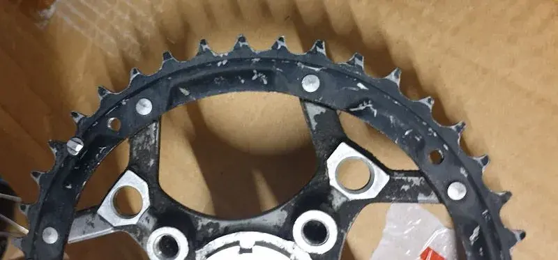

Is it just me, or could you actually convert the spider to a standard triple?
Cut the extended bits off that join to the fixed outer, neatlu of course. Then file a step into it to allow the outer ring. There is already extra meat on there to put the fixed outer ring in the right place, spaced from the middle, and there is even a handy guide line inside the bolt hole by the looks of it. Shoot me down, but it looks very possible to me.
While I think this has been sorted, if you search the forums you'll find 4 and 5 arm spiders can be fitted to these, the 4 arm come from later cranks. I think a small amount of modding is needed for the 4arm. But that is normally for use with the XTR arms.
