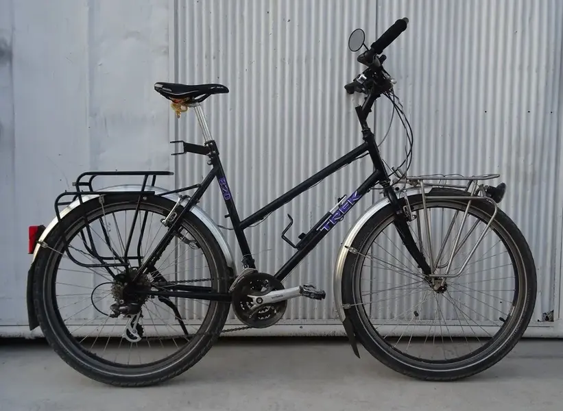

This was the set up on my wife's bike for our South America tour last year. Tubus Cosmo rack (very short distance from vertical strut to front of the rack, plus low railing to install panniers a bit lower). At the dropouts I used longer bolts with a few spacers to avoid conflict with the fork legs. At the top the rack is attached to the fork crown using a steel light bracket like this one, very sturdy. After 6000km in all surfaces with 2 big panniers and a tent on top, not a single issue.
I'm meant to write a short tutorial in my blog with more pictures but I haven't got around to do it.
