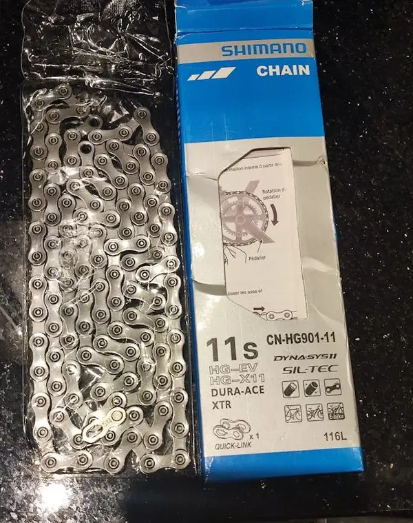

Took a punt on a chain thinking it's probably a fake, out of intrigue more than anything. If it isn't, great, if it is, then no harm aside from seeing how good or bad it is.
On arrival it didn't have the hallmarks of a fake. Box looked good, printing seems good, none of the usual spelling mistakes. Instructions also seem to be the quality you'd expect of a genuine item, again no typos,nice paper and in various languages.

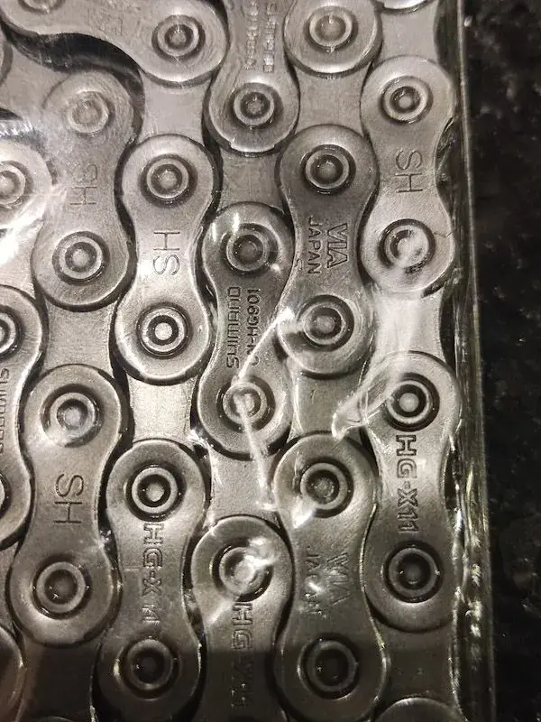

I've not had a Shimano chain for a long time, this one is 11sp with quick link. Stamping on the links seems to be good and uniform. It only has them on one side of the link, no idea if this is how Shimano roll these days.
So is it real, fake, bad fake? Any ideas? How can I test it to see if it's up to the intended task if it is 8ndeed a fake, and should I even bother trying to use it?

That looks genuine. I compared the same chain in my shop and everything, if it is fake, is identical. The quick link should have small "shimano" etching on each side of the slotted hole and the chain packet will have a pink slip inside and then a UK and Japanese recycling symbol.
I bought one from ebay that when arrived I suspected to be fake due to usual tell tale signs with the packaging, but on arrival and compared to a genuine shimano chain I could tell the difference, link length, width, stamping etc was identical, so it appears IMO, there are some genuine ones out there but are factory 2nds, maybe this is what you have
