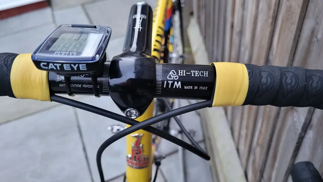

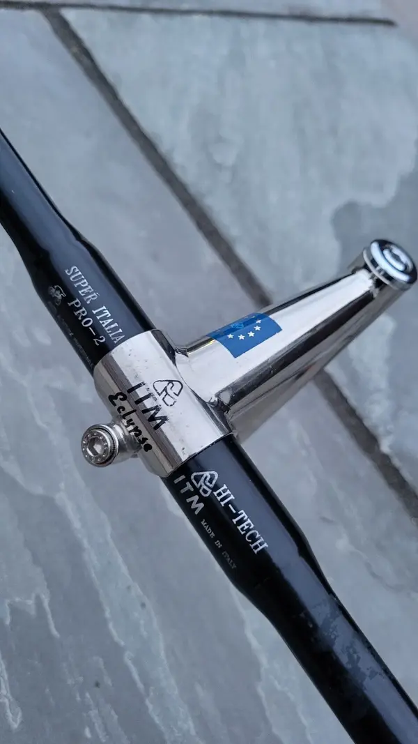

Caved into the pressure and decided to donate my ITM bar and stem combo I purchased for the merckx project. After fitting I wasn't happy with the look so went for a black stem and bars.

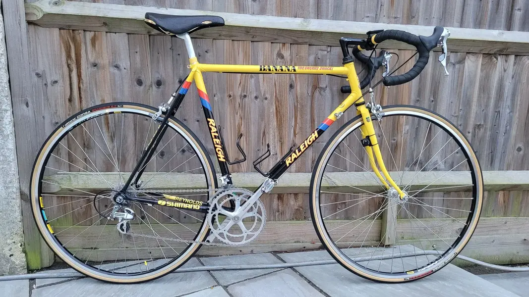

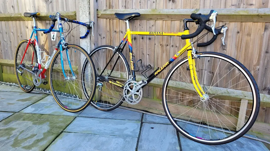

My Raleigh Banana build was completed recently and thought I'd share a few before, during and after pictures.
The bike started out as an ebay purchase and came with good paint and an original 105 / 6 speed groupset.
The plan was to improve the running gear so I decided on the tried and tested Dura-Ace 7400 group with a few modern twisted.
Hope you enjoy.
