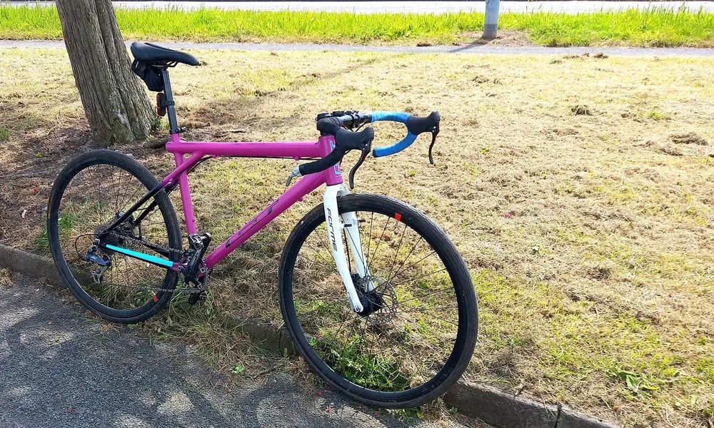

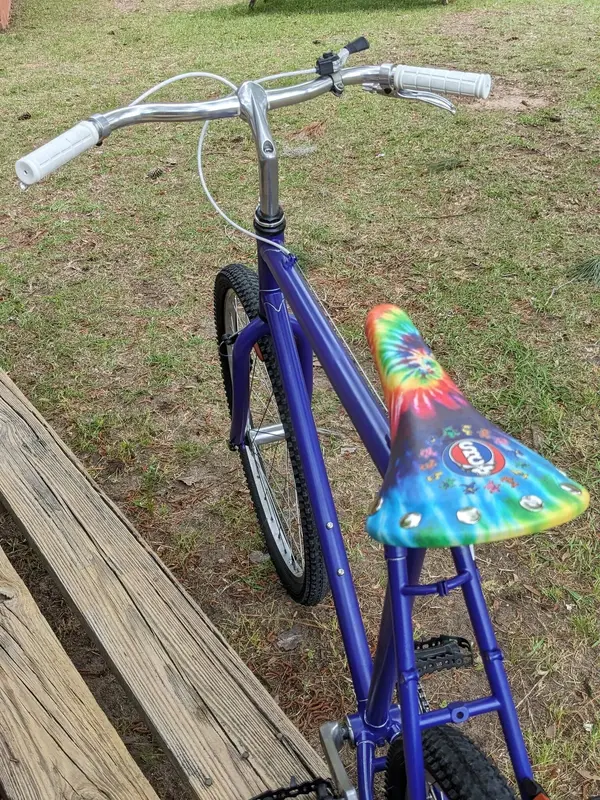

The paint is easy, just spray it... the clear coat requires a bit more care, but not much more. Wet sanding takes care of any goofups easily enough. The bike in the pic had three coats of clear, then three more with sanding in between ... I wasn't slathering it on tho, basically just used the whole can. It came out shiny-ish, I guess...
It was kinda cool that I could line the lugs relatively painlessly with an extra fine tip acrylic pen I got off Amazon ... that there's the advantage of acrylic in my mind ...

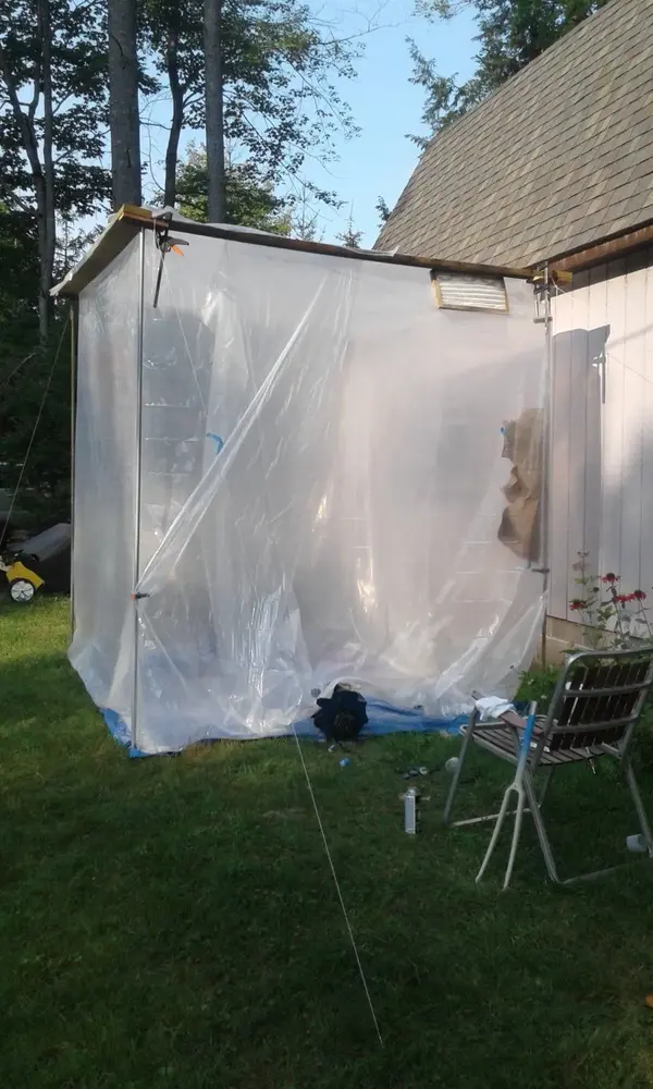

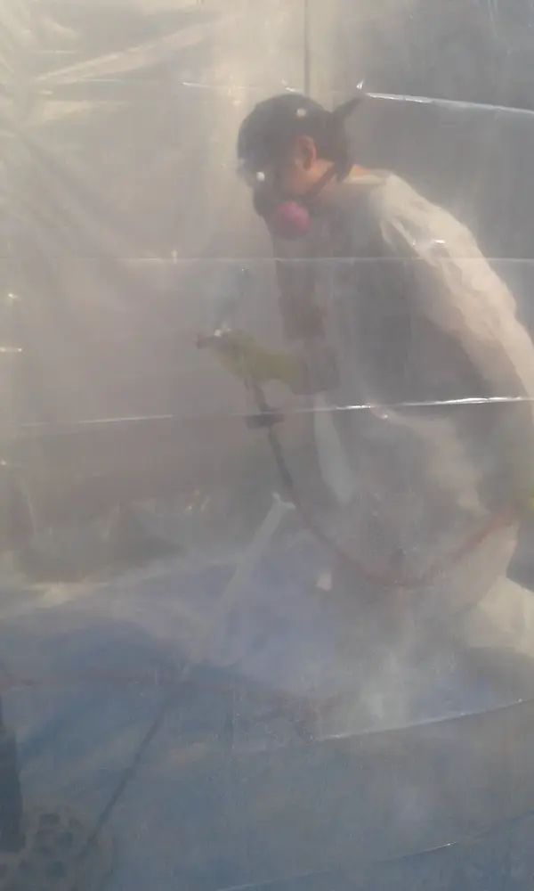

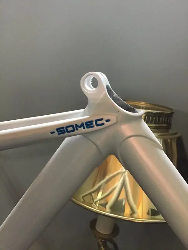

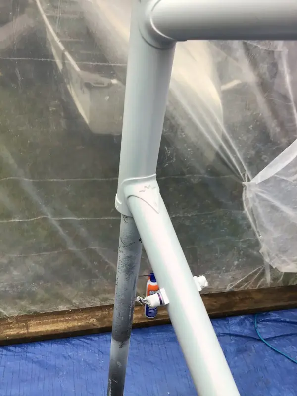

It’s not cheap to use rattle cans to spray a bike. Prep takes forever. Powder coating is cheaper and faster. Here, $100 for a frame and fork powder coated. If you just want paint to cover up rust and you’re building a maggot, the spray cans are good. You can spray the whole bike without disassembly if all you want is to cover rust, or use canned paint and a broom. Rattle can paint chipps off with your finger nail. Unless it’s 2K. Add up the cost of stripper, stripper wash, many grades of sand paper, solvent wash, rust remover, rust neutralizer, primer, color coat and maybe clear. It adds up to more than powder and isn’t as nice. For a professional quality job you need a paint booth so dust and aerosolized over spray doesn’t settle on your paint. You need a furnace filter intake and an exhaust fan to get a real professional job. High quality automotive paint can be purchased in small amounts from people that sell paint for motorcycles. Her is my home built booth. The bike is a vintage Somex I painted pearl white over candy. You have to use a low volume, low pressure spray gun, not a high vol, low pressure gun. Those are for cars and make too much mist for a small booth to clear. 3927720E-782D-4EB8-9B35-85B9BE375BB1.jpeg

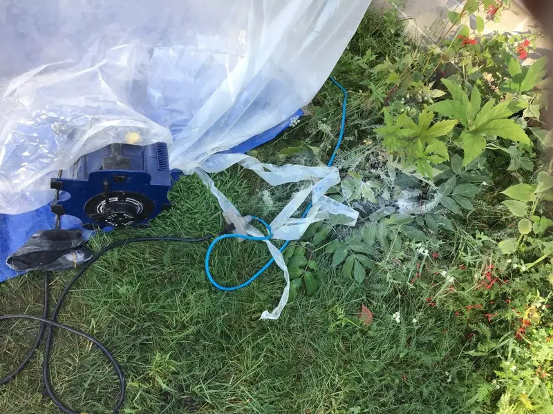

Blower with removed overspray killing my wife’s flowers.

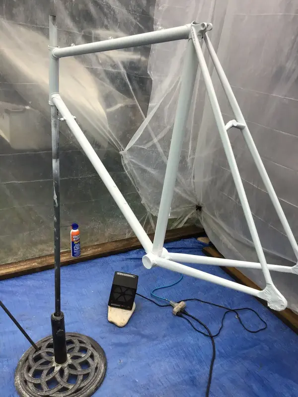

Heater for cold mornings

furnace dust filter, upprt right
It’s not cheap to use rattle cans to spray a bike. Prep takes forever. Powder coating is cheaper and faster. Here, $100 for a frame and fork powder coated. If you just want paint to cover up rust and you’re building a maggot, the spray cans are good. You can spray the whole bike without disassembly if all you want is to cover rust, or use canned paint and a broom. Rattle can paint chipps off with your finger nail. Unless it’s 2K. Add up the cost of stripper, stripper wash, many grades of sand paper, solvent wash, rust remover, rust neutralizer, primer, color coat and maybe clear. It adds up to more than powder and isn’t as nice. For a professional quality job you need a paint booth so dust and aerosolized over spray doesn’t settle on your paint. You need a furnace filter intake and an exhaust fan to get a real professional job. High quality automotive paint can be purchased in small amounts from people that sell paint for motorcycles. Her is my home built booth. The bike is a vintage Somex I painted pearl white over candy red.

The spray booth and Somex I showed above was painted with 2k paint. Two part Epoxy primer, two part red candy, two part pearl and two part clear. Very fine wet sanding between each. If I do this again using 2k I’ll get an outside + pressure air hood. There are some under $60. It might cause turbulence in the booth, blowing overspray around but I’m using a commercial floor drying blower. That should remove any additional overspray. I also have an infrared heater on a rock in one of the photos. When the temp is optimal for my dryer I turn it off and spray.
