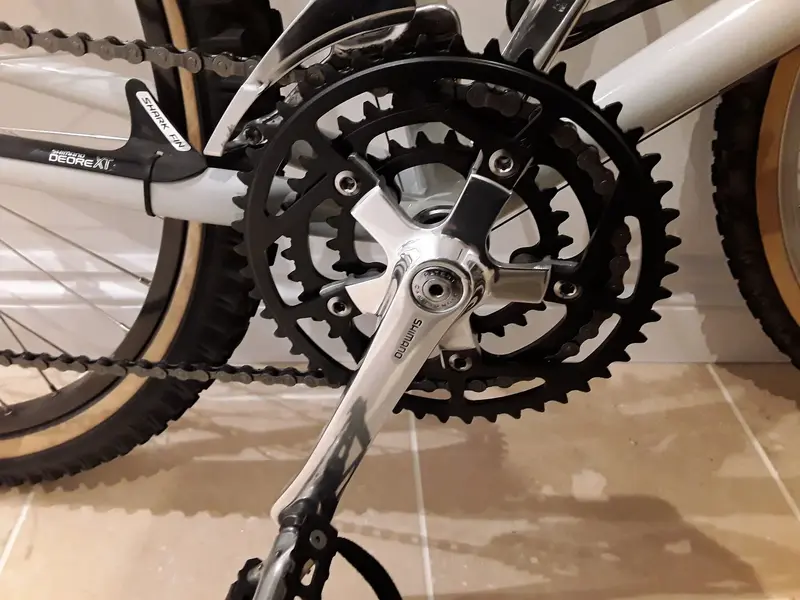

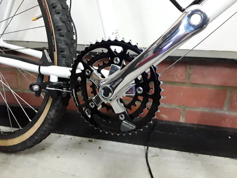

Photo below grey frame is of some cranks i did 4 years ago.....nothing other than a acf50 wipe on occasion.
The white frame is a set i did 2 years ish ago and today i buffed with autosol....1 coat, not really much effort....back to shiny.
