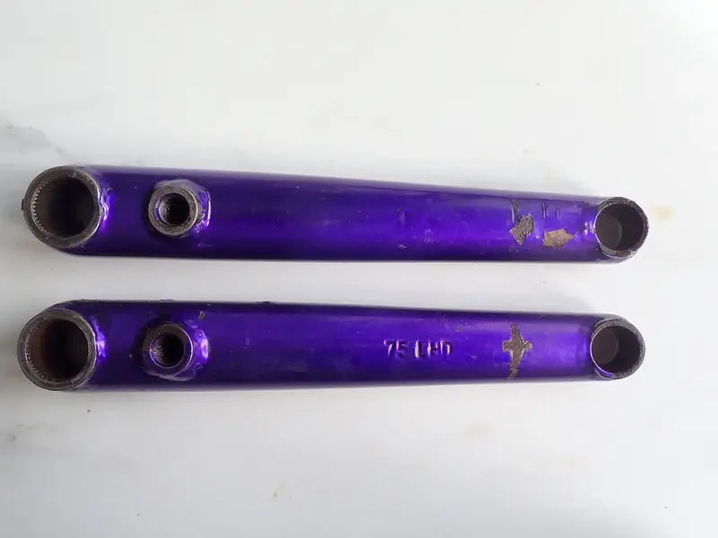

I bought some ratty and relatively cheap Profile cranks in a delightfully mid-school purple colour, because I've been hunting for a decent set of chrome ones for absolutely ages to no avail (Is Profile chrome particularly poor quality and prone to pitting? Anyway....).

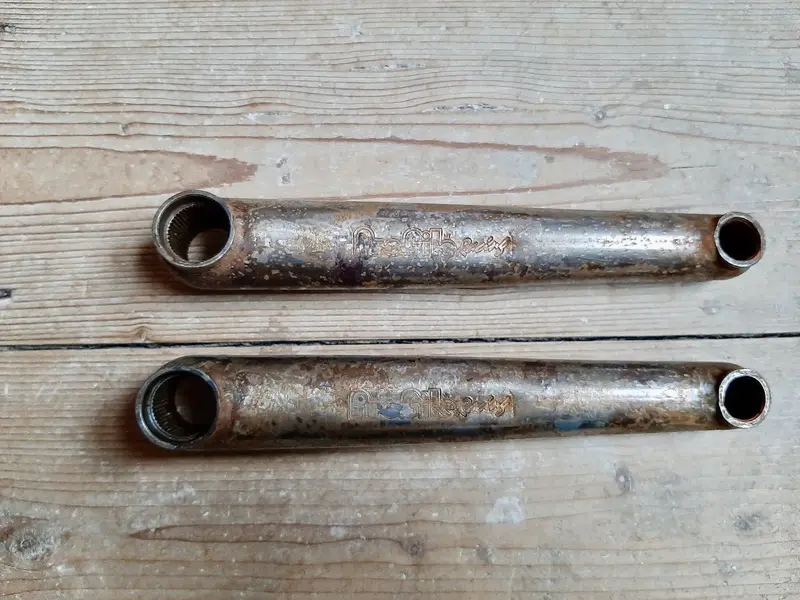

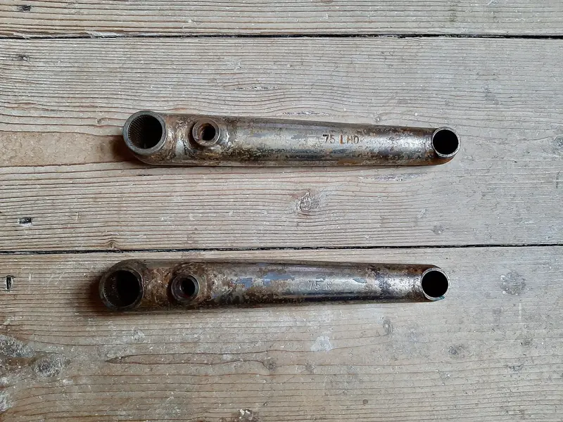

Here they are: P4090437.jpeg P4090436.jpeg I then stripped the paint off myself using Wilko paint remover and wire wool, easy enough:

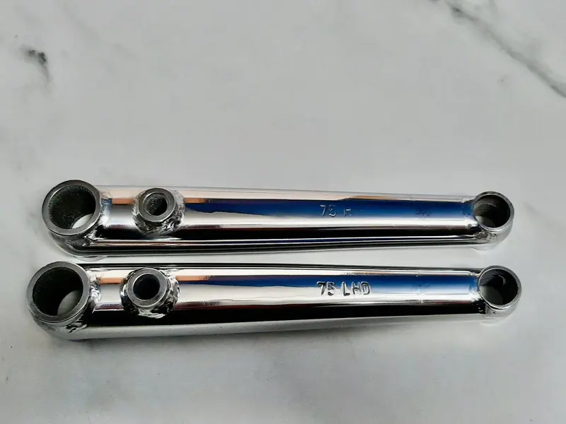

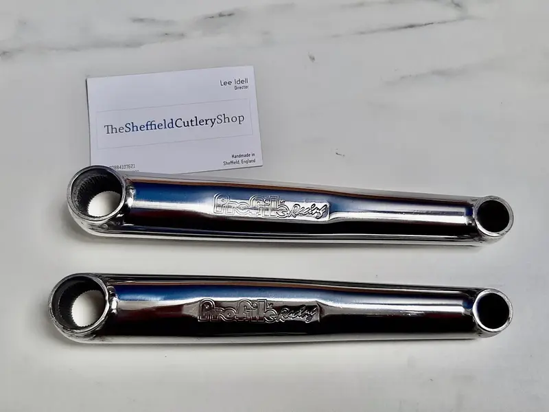

And then - cheat mode - I took them to the cutlery factory down the road (benefits of living in Sheffield :) ) and got them to polish them up. They did an absolutely fantastic job, if anyone is interested their details are in the photo.
I will clear coat them with 2K lacquer as soon as it's warmed up a bit outside.

It was £30, I just popped in to ask - the guy was very friendly and said they do a lot of motorbike stuff. Overnight turnaround.
They just use massive industrial buffing wheels and a lot of rouge from what I saw.
