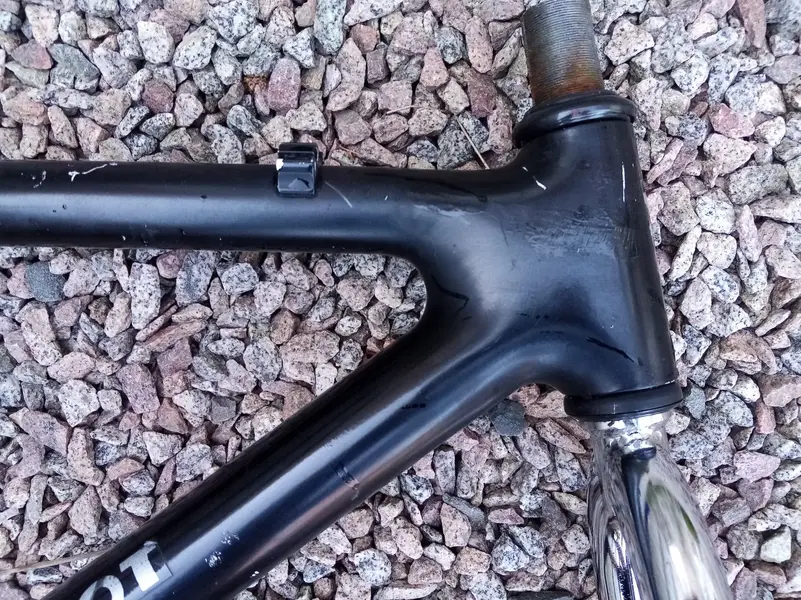

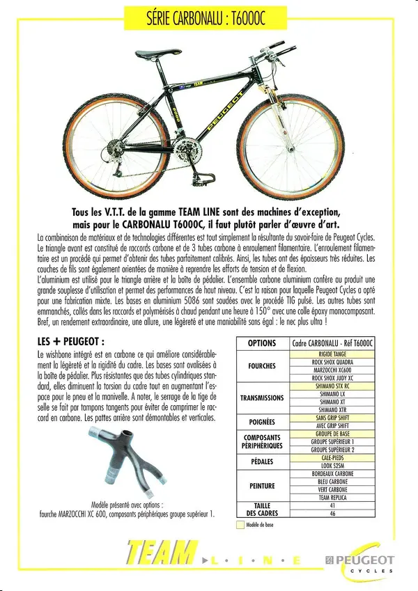

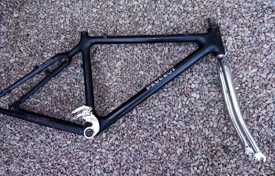

It's a Peugeot, and looks broadly similar to the "Team line" frames from 1994/95, which use aluminium tubes bonded into carbon lugs. Interesting...
It differs in that it has a regular split seat tube and clamp arrangement rather than the internal clamp system, and the mech hanger is non-replaceable. So maybe a lower budget version, or an earlier version.
It came with most of an STX-RC groupset, and the chromed Rigid forks (threaded forks with an Ahead set and Ahead stem fitted, so who knows what's original!).
A quick polish of the downtube seemed to yield good results, so I'm hopeful that with some work the frame can be made to look half decent...

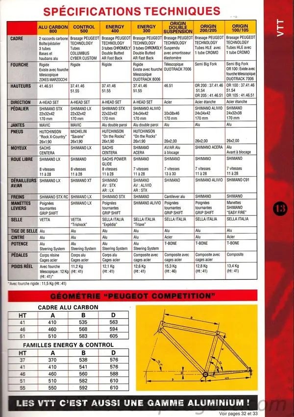

From the catalogue...

I guess just tidy it up and build it with the parts I have available, I think it's 16 or 17" centre to centre, so it may turn out a bit on the small side for me. It didn't cost much, so we'll see how it rides...
