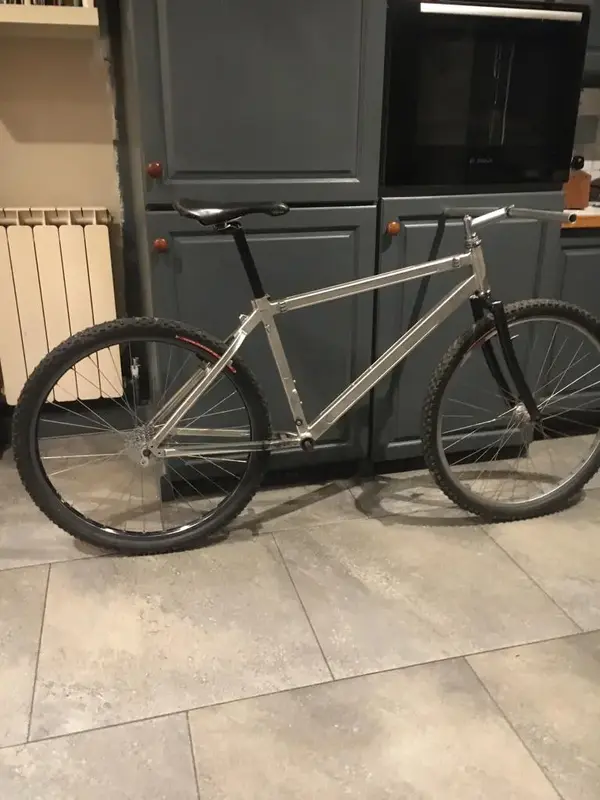

Pace rc200 f2 'period correctish' restoration

So we've sorted mechs from what we had.
Going to put some wanted adds up shortly because we're now after:
* Handlebars (and I've seen something in the for sale forum we're going to ask after) Think we're sorted here?
* 7 Speed block (is anyone likely to be selling these or should we just go new here?)
* Crankset- will and XT work with that bottom bracket (will ask after measurements)?
* Dia-compe 987 and SS-5 levers (she prefers these, having used both 'back in the day')
* Anodized chainring bolts and skewers (purple is a favorite, but other colours maybe considered?)!
Getting there! Thanks to @Tootyred for the first two and talking to other members about the brakes. Thread for Crankset about to go up shortly.
We need to replace the brakes boss screws since one on the rear is threaded and another isn't great, do we need m6 or m8, particularly if we're going to Dia Compe 987?
@raidan73 was asking what else we need, so thought I'd put a wants list in here
*Triple rings for 110bcd Suntour XC Cranks, Pref Pace or Blackspire and also anodized bolts. Intrested in Blackspire since she spent a lot of time in Canada and used their rings. But would consider other options? 11- 28 at the back, she's said she doesn't want to go bigger than a 24 for Granny ring and in fact would prefer smaller.
Also need appropriate nuts and spacers
* Chain- is it worth looking for an original hyperglide or will modern 7 speed chains work?
* Poss seatpost, can anyone tell us the diameter in case the current one is too much
