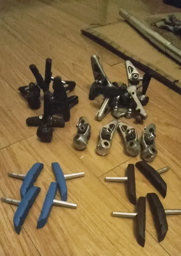

Right now it's all on brake choice...
Functional v's Vs canto power.
Dancing with TAXIs and tourists require a nice responsive braking system.
I have the original DX brakes.
I also have some period m732? brakes in black I could use with the matching levers from my 91' kona to run cantilever from the original roller stem.
Would the old XT suffice if I added some fresh Ritchey pads in there?

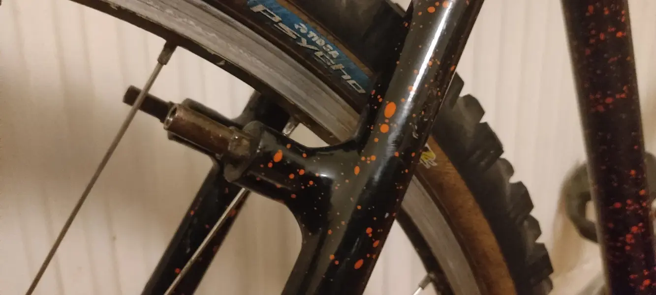

Brake posts on the frame are super extended for some reason. This may influence choice further...

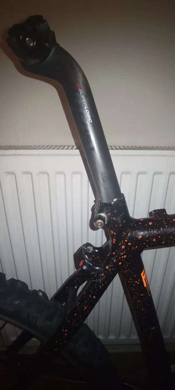

Original sestpost could be used here as could a black syncros and for even more heinous retro-mod crimes a carbon ritchey superlogic.

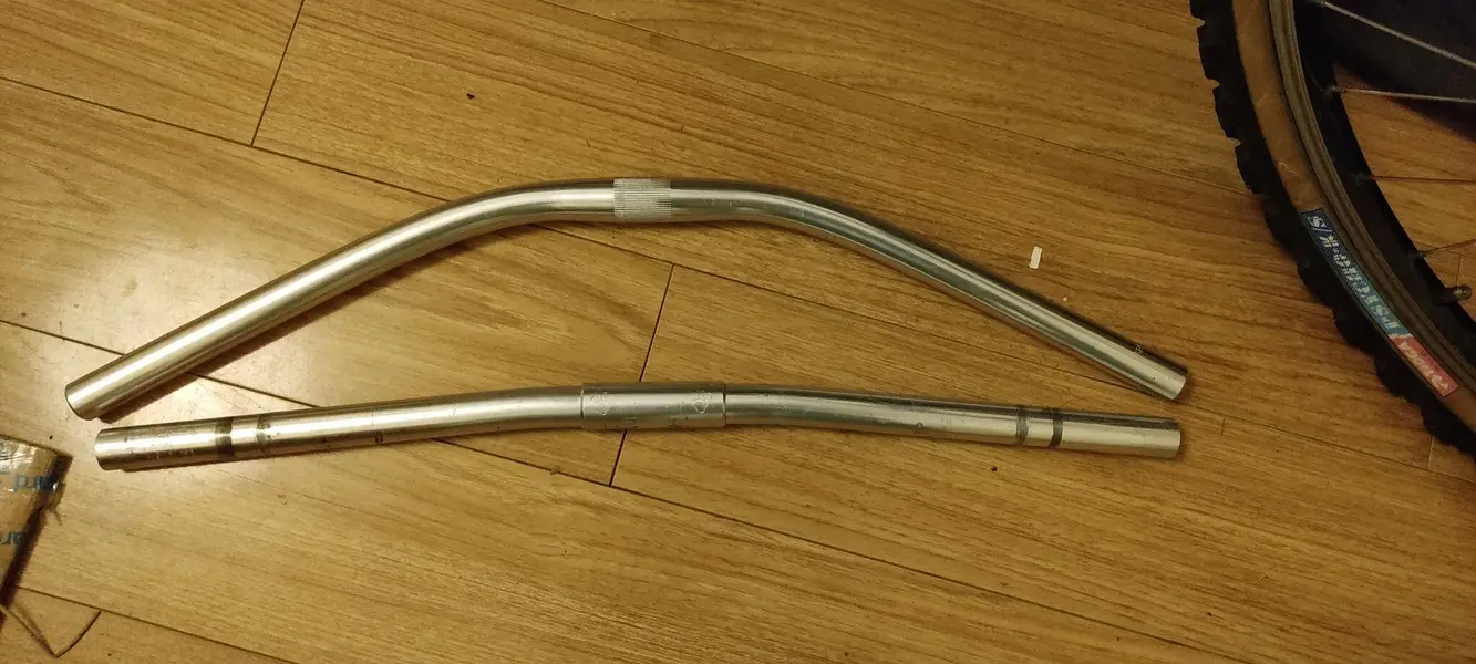

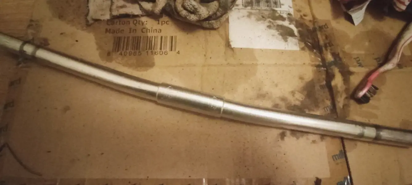

I have the notion of using something with some rise or sweep (?l) and have some titec hellbent xc's installed for mock up.
This clean swept back set should fix the sizing issues however these ITM flarbars look nice and period to me.

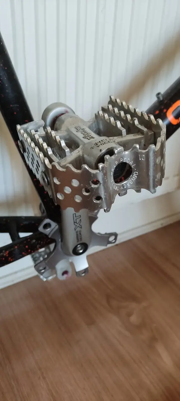

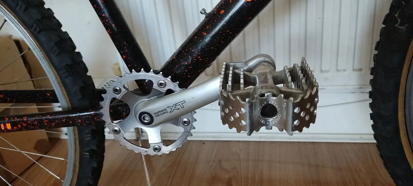

Chain set and pedals.
M750 is satin 34 tooth polished TA and some 01 reissue triple traps.

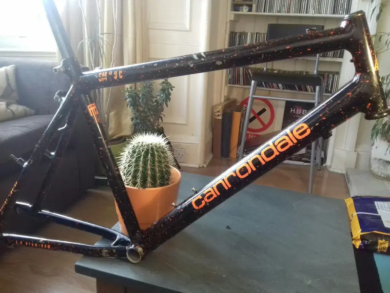

Mismatch numero uno perhaps. This isn't gonna be pretty, function and comfort over form, although having said that it does have a glimmer of hope. IMG_20240127_154625.jpg IMG_20240127_152650.jpg

I'm unsure how to even measure this beast.
All I know is it is at least as tall as a 17.5" (19") Marin I had as a sprouting lad, if not a bit taller.
C2c or c2t is all well and good however this has the high BB to factor in.
Running 175mm arms.
(Note to self - measure this thing and stand over)

My guess they made those frames in 18, 20 and 22 inch. Your one there looks like to be a 22 inch frame going by the size of the head tube. I am 5'10 and a bit just short of 5'11 and the 18' is perfect due to the high BB, a standard M series frame I would be a 20 inch size. A 22 inch would suit someone well over the 6 foot mark on the SM800 or M800 around that era, maybe even 7 foot. (My 18 inch M800 from 93/94 measures 16 inch from the centre of the BB to the top of the seat post upright, maybe that will help you measure it up).
What height are you? The geometry on those frames are deceiving until you build and sit on the bike.
I'm around 177cm and normally ride 16-18" frames which everybody tells me are too small!
I will give this a chance, I feel an 18" would fit me better than this. The sm800 came in 18" 20" and 22" sizes only so the catalog states.
Edit : if this is a 22" I'm screwed. Sometimes it is about the journey not the destination :)
