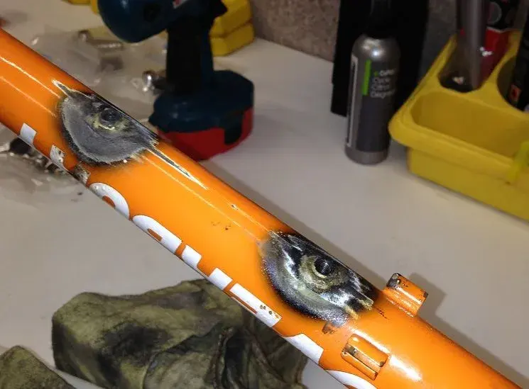

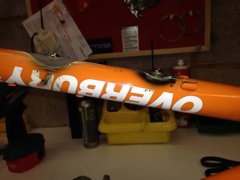

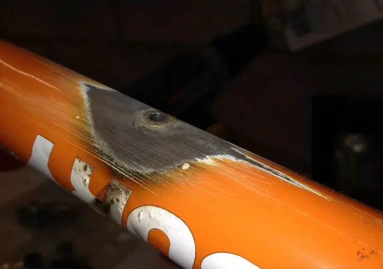

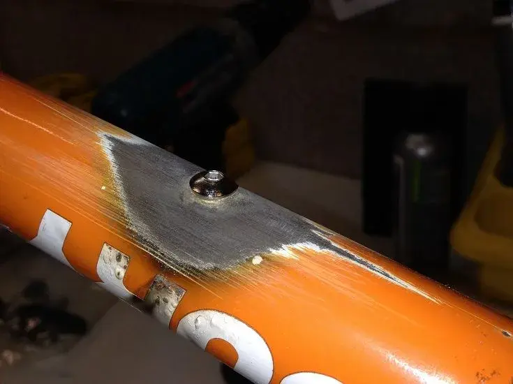

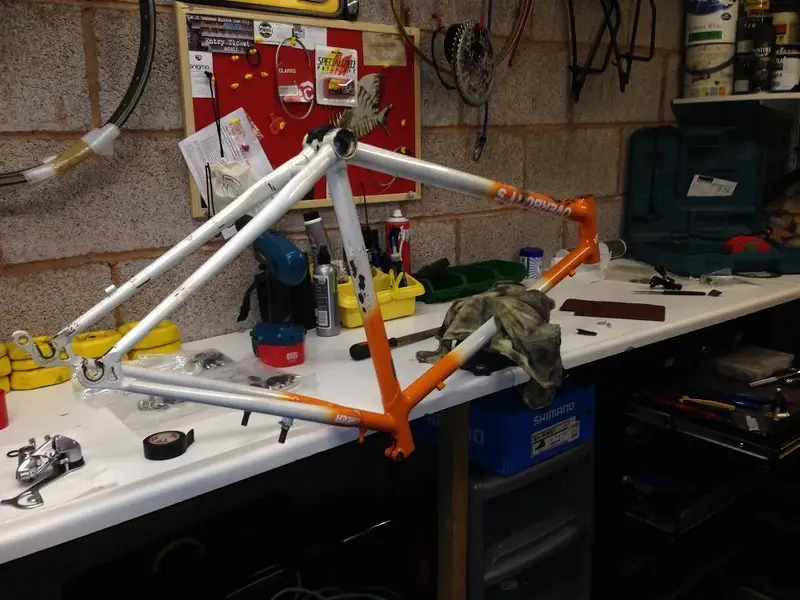

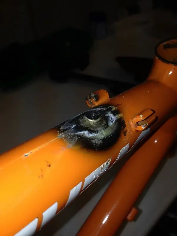

Got the frame back from the frame builder, he had fitted a couple of braze-ons for a crud catcher, I know some may not like the idea but like I said its going to be a rider and I'm no lover of elastic bands and cable ties, especially if I'm splashing out on a new paint job !
I don't want the bosses to be proud so I've filed them down, I'm going to order some domed titanium bolts that will be painted to match the frame.
This is a side shot of before and after.
Next is to strip the paint back and clean it ready for paint !

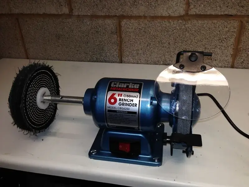

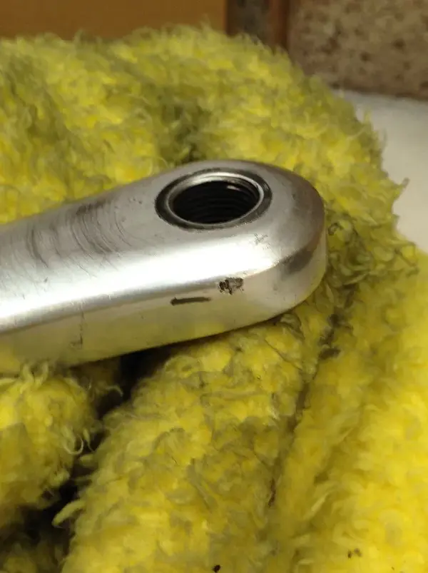

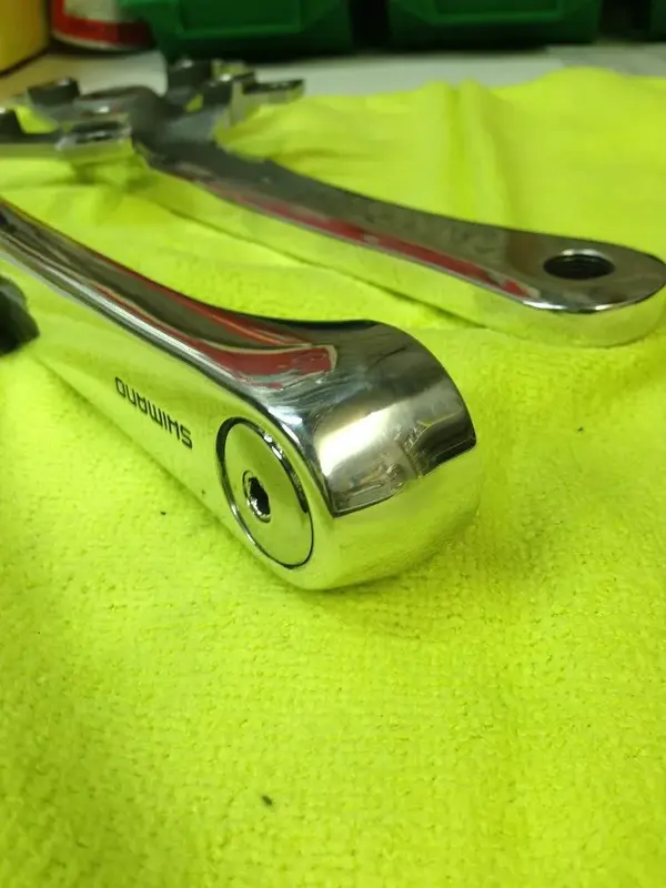

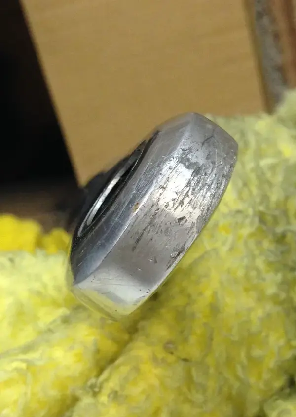

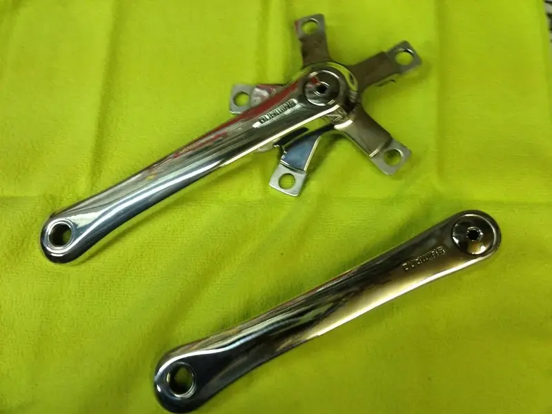

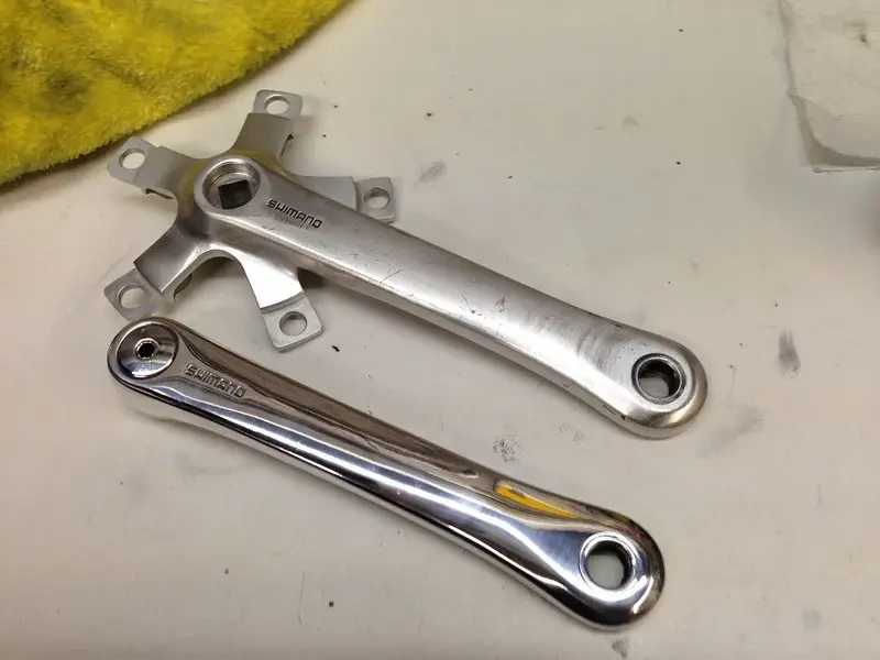

I've spent the last two afternoons lovingly polishing my XTII crank arms that I purchased from Treacle, they were in pretty good condition but had the usual scratches and dings to the sides and ends
I used coloured sisal mop with a green polishing block, this took all the scatches and dinks out of the metal, i'll follow this with a blue polishing block on a white soft mop to finish.
Even though they are looking nice when polished, I'm going to get them re-anodised silver to match their original look, I just wanted them looking clean with to scratches or dents. :roll:

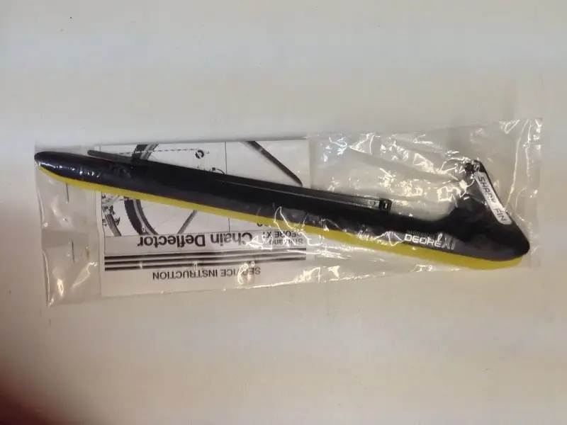

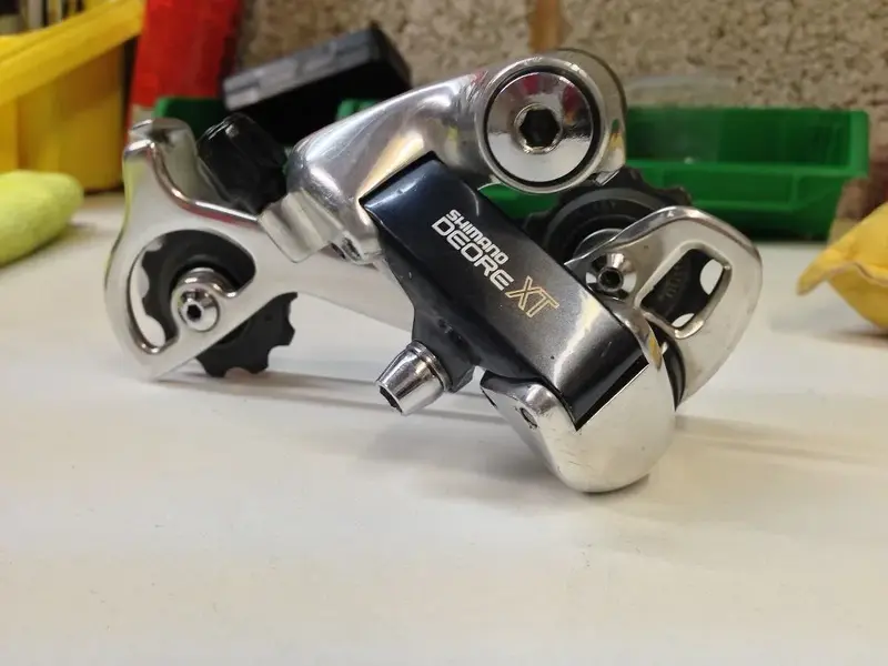

I've managed to get another M735 rear mech in good condition, it cleaned up well with a couple of tiny marks on the parallelogram plate, there were a couple of small scratches that were not deep and they polished out using the buffing wheel.
The M736 front mech was already in near mint condition, it looks like it was fitted but not used with a couple of light scratches to the back plate

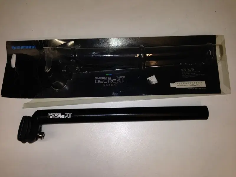

I found a NOS 26.8mm XT seat post, the packaging is brittle but the post is mint.
Panaracer Smokes ! nothing like that new tyre smell ! :D

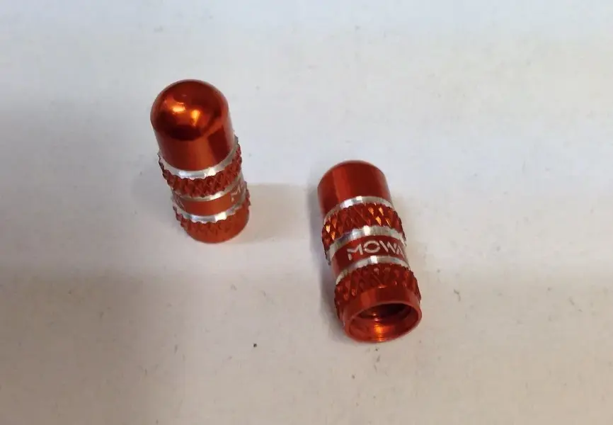

And a couple of finishing parts, a NOS "Sharks Fin" and a pair of presta ali caps in orangethe orange ano looks more "bright" in the flesh.
