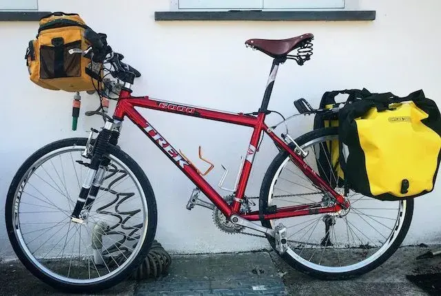

I have a late 90's Trek 6000 which I've owned from new and which has, at various times, been my play bike, commuter bike, exercise machine and London transport alternative. I really don't see myself doing any real mountain biking stuff in the foreseeable so the bike has become my exercise and grocery shopping bike. I'm returning to cycling after a long lay off and have a road bike for long/club/fast/race type rides but as I'm also into hiking/backpacking I'm considering doing some longer tours and have just picked up the France en Velo book which has fired my imagination for a possible holiday next year.
While I have it set up for reasonably comfy riding with luggage, I think the frame is too small really and I would benefit from a frame that's larger and has the appropriate mounts for panniers and mudguards and to get a solid fork in case I want to put on front panniers too and preferably steel in case I need to braze mounts on. I've recently picked up a bargain Shimano dynohub front wheel to experiment with dynamo lights and usb charging and I'm looking at some trekking bars to add a few hand positions.
I guess the big question is, is it worth getting something like an old 80's mtb or touring frame and moving all the components over to create a specific touring type bike? The bike has recently had new chain/cassette and a full service from the local shop. It has Shimano STX 7 speed components & Sugino Impel cranks. if I did, I'd put in a new bottom bracket given the age and possibly a new headset.

That works for me (per pic), although not sure about shocks.

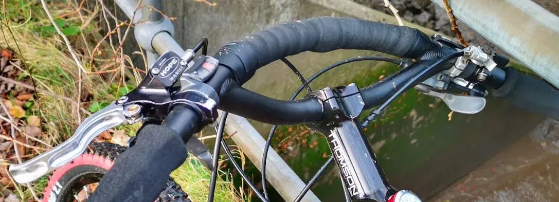

I used to tour decades back on my long gone Raleigh Royal with rear panniers & bar bag. I now prefer the option to get off road onto gravel & dirt so plan to use one of my Orange P7's. I've used one with V brakes & rear panniers & it was great but I built up a 2002 P7 with disc brakes which is now going to be my default bikepacker when restrictions are lifted. I've got Alpkit bar-roll, stem-cells & frame bags up front & a seat pack for the rear. Like you I'm a backpacker so got lightweight kit already. If I decide on panniers I'll swap the rack of my V Brake P7 (redundant commuter, like myself!). I've short travel Pace forks on it & plan to stick with them for now. Got rigid forks in reserve if I change. Best change I've made is adding Humpert Space Bugel bars. Really comfortable over distance & good for lashing luggage too.

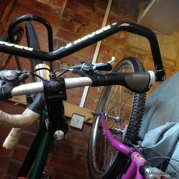

They can make a very good tourer. Here's a very rubbish shot of the front end of my converted 1990 Saracen. It has done a lot this bike, from race to child seat donkey. It originally came with a 150mm stem so a slightly shorter Softride makes for a comfortable ride.
1.3 slicks and Limpit front pannier mounts help with on road tours. The more hand position question was answered by not changing a thing. I have had these Durrango XC bars since I bought them at the Worlds near Plymouth I can't remember when in the 90s.
