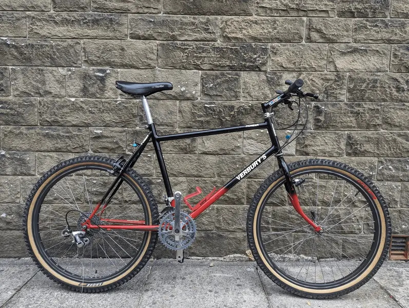

Due to injury, I won't be riding for a few weeks, and when I do start riding again, I'll be digging out the 1994 HardRock on account of its easygoing, comfy, more upright geometry—at least for a while, until fully recovered. Indeed, due to the short-ish top tube relative to overall size, the Hardrock's entry level geometry is great for those of us with legs that are long-ish relative to reach. But while the geometry might be from heaven, the tubing is not: plain gauge cromo. That's not terrible, and it's certainly tough, but it doesn't have the lively feel of higher end tubing.
But higher end tubing is usually formed into longer, lower, racier bikes, which I won't be riding for a while, and don't always want to ride anyway. So, here's the question: which manufacturers, if any, produced a bike with easygoing, 'un-racy' geometry but higher quality tubing? I'm thinking of double butted cromo, perhaps Tange Prestige or equivalent. The upper end of the not-especially-popular mid-90s Ridgebacks are the closest I've found. But is there a brand or bike I've overlooked? Any ideas, anyone?

89 to 95 Marin and mid 90s+ RM have long head tubes. 180mm on a marin and 175mm on a rocky. Thats on xl, but all the range is long for size. Add a 30mm shorter than standard stem with rise.....and in my case 30mm riser bars......and your there.
But it depends on what bit of you is damaged......
As for tubing, its a bit if a personal thing imho. Prestige on older marins is no lighter than standard tange cr-mo of a few years later. But it rides very different. I love it but many....especially if your a alluminium rider....hate it. Its not in any way stiff and flops about. But then I'm light and have 30+ years getting the hang of the bike bending round corners🤣.
Personally i think the butting and build quality is more important than the tubing....within reason.
Ive got a 95 fusion, modified for my issues, its very good...better than i expected and thats just good old tange db cr-mo. It also weighs in exactly the same as the 89 to 91 prestige frames......progress hey!
