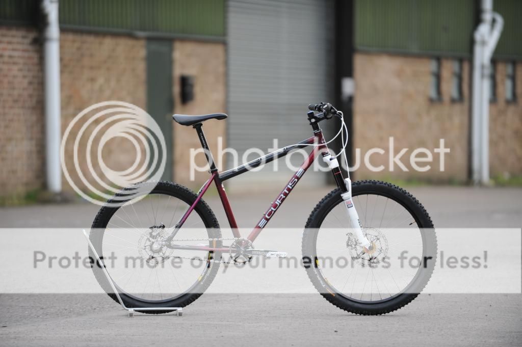

I thought I had better take a proper photo of the bike, before I do any more work to it. The only pics of it are either ropey iPhone pics, or pics in the woods. Usually both.
In a few weeks time I plan to strip the bike, sort out a couple of niggles on the frame and get it painted. I have been to the local sticker chap who has a list of things I want, which may be ready next week.

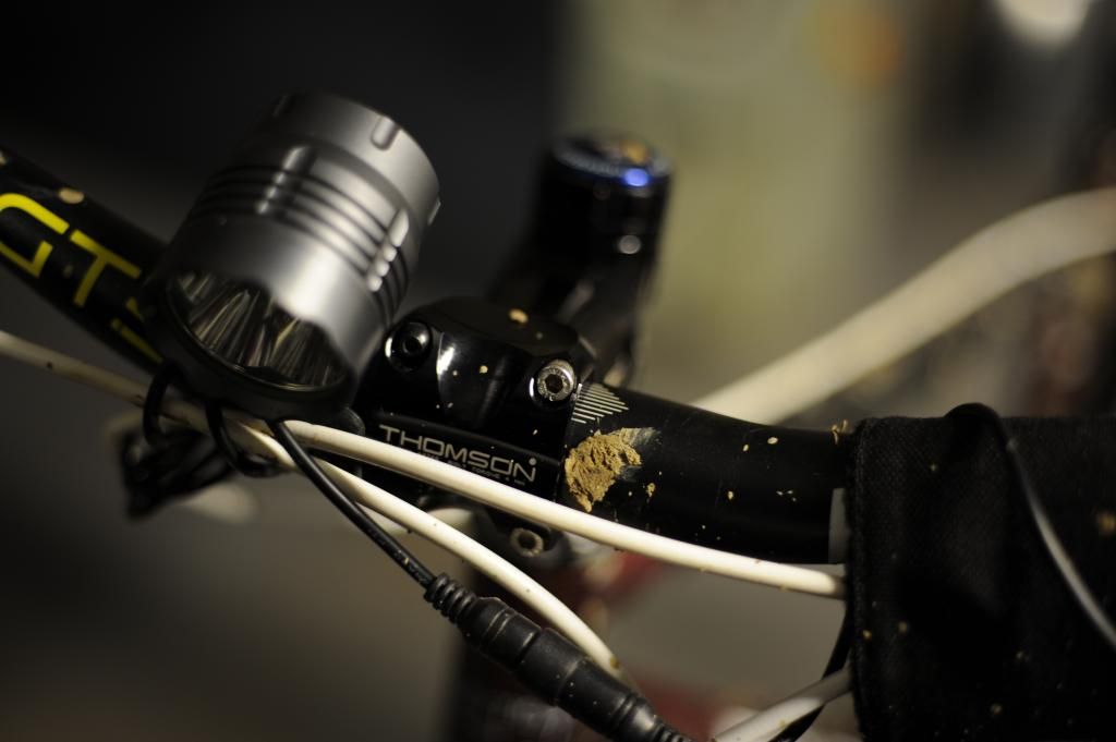

Yesterdays ride was odd, part way round I noticed that the brake levers were in a funny position, rather high up. I put this down to my fitting them weirdly when swapping the stem, so I just readjusted them to a more usual position and carried on. Then after the next rough section, I noticed they had moved again! On closer inspection, the stem bolts had worked loose, which is a pain as my multi tool doesn't have a 3mm key on it! I tried to persevere, and didn't want to miss all of the best bits of the ride, but it was starting to get dangerous. Luckily(!) two bolts has loosened them selves almost out, so I upgraded the two bottle cage bolts to stem duty, and carried on. :)

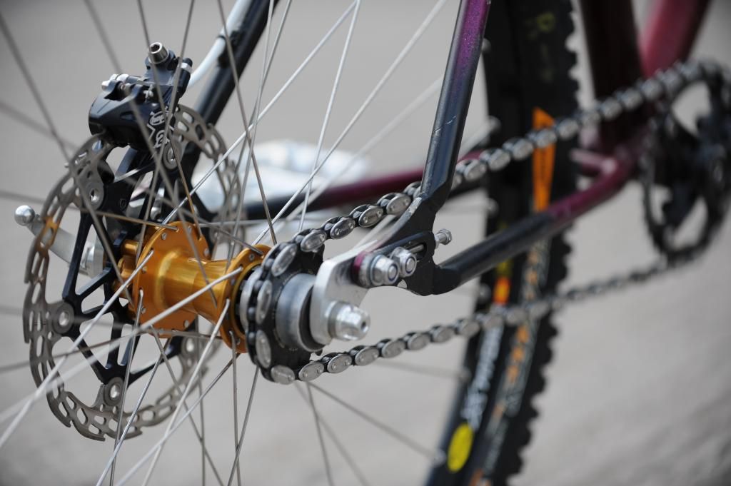

This morning, I decided to finish the frame. Having thought properly about it, I realised that I still wasn't happy with the position of any of the cable guides, so cut them all off and started afresh.
With all of the cable guides off I could make sure that the whole area was flat and perfect before adding the new guides.
The brake hose guides I have positioned on the top of the top tube, centrally. I have also biased them more toward the front so that the brake hose flow more tidily from the master cylinder. I have also decided to keep the facility to add a dropper, tho I probably won't bother getting one. There are now two guides on the lower left hand side of the top tube, hopefully you can see here the routing the hose would take.
I've made a video of the proposed hose route, but my phone has gone flat and I can't upload it to potatobucket..
The hose guides on the seat stays are also redone, I have arrowed the brass telltale where one of the previous guides was so you can see just how much further up the stay I think they needed to be:-
