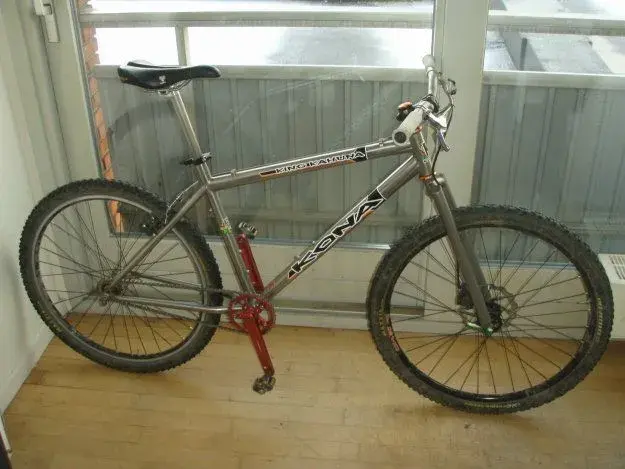

Kona Collar's - so this is what i need...
Does anyone have a close up picture of one, as ive seen them used on bikes with V brakes - which i find quite hard to understand as they were designed for use with cantis right? Or is it me??
And indeed if you can buy them new or is it something i have to wait to crop up??

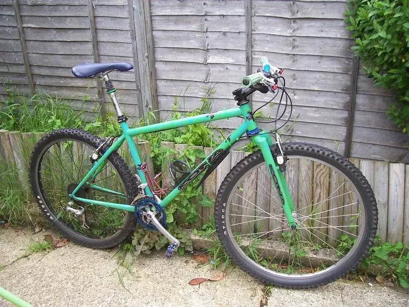

Also - does anyone know what these forks are please?
I thought they looked quite cool - how do they compare to the P2's?

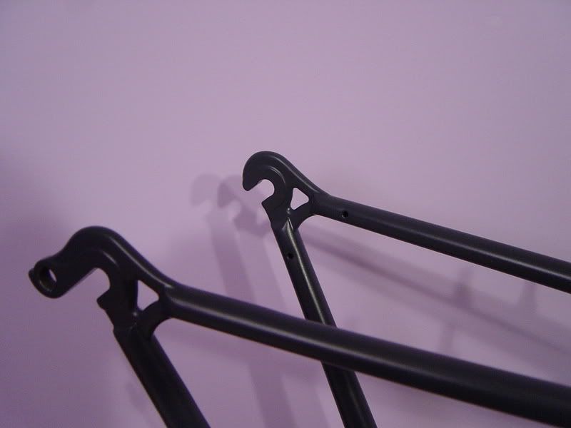

I had my frame powder coated at Windridge - not the cheapest of jobs but I was very impressed with the service / quality / looks etc :
http://www.windridge.co.uk/content.php/410
The frame was ordered as satin but the forks show what gloss level can be achieved with powder :
