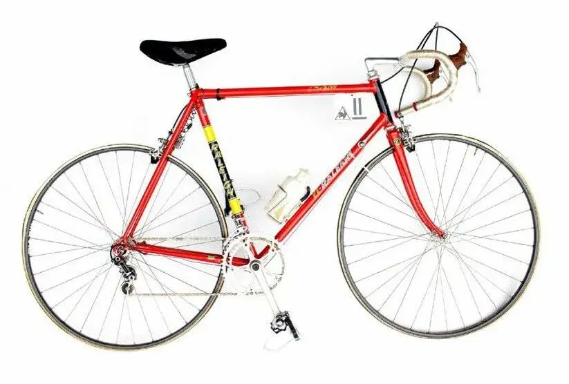

** The document used by Raleigh UK – the section titled ‘Some Successful Designs’, list’s Joop’s seat tube length as 560mm. However the preceding page tells anyone reading this information that they must read this as Centre to Centre.
https://raleigh-sb4059.com/2020/09/28/4 ... sbdu-data/
Raleigh have taken Joop's original size 56cm Centre to Centre seat tube length and translated it to a size 57.5cm Center to Top by adding on 15mm. This is the correct conversion measurement...IT IS 15mm NOT 10mm
"The ctc size given for Raas was 565mm – my JR frame is 565mm ctc. Add 15mm to that and you get 580mm, or 58cm! The size of my bike! There it is, 100% actual first hand indisputable SBDU evidence of the size of the bike ridden by Jan Raas. No more internet speculation, just good old facts!"
https://raleigh-sb4059.com/2016/08/05/j ... rame-size/
Joop Zoetemelk's 1980 TDF winning bike is a size 57.5cm CTT.

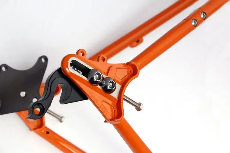

Okay, try not to keep worrying about the brake pads and focus only on the tyre and chain stays... what happens as the WHEEL POSITION IS ADJUSTED FURTHER BACK ?
Look closely at the chain stays as they get wider apart... what does this tell you ? .... what will this allow you to do ?
I think we're talking at cross purposes here. I'm fixated on inexplicably mis-matched brake drops, and as far as I can tell, you are fixated on fitting balloon tyres to a road bike?... :)
Re: Re:
Well done Sherlock, you've finally cracked it. :D
Now with the evidence presented it has become clear part of the design brief was to allow for larger tyres as well as being able to retain the original wheelbase with 23mm tyres. I agree they are not as pretty as the short Campagnolo originals and a compromise had to be made. They are in the spirit of the originals with triangular windows and spring loaded adjusters...I would consider these to be a key detail which Raleigh has retained... that's cool with me... much better than some of the funky alternatives out there. :cool:

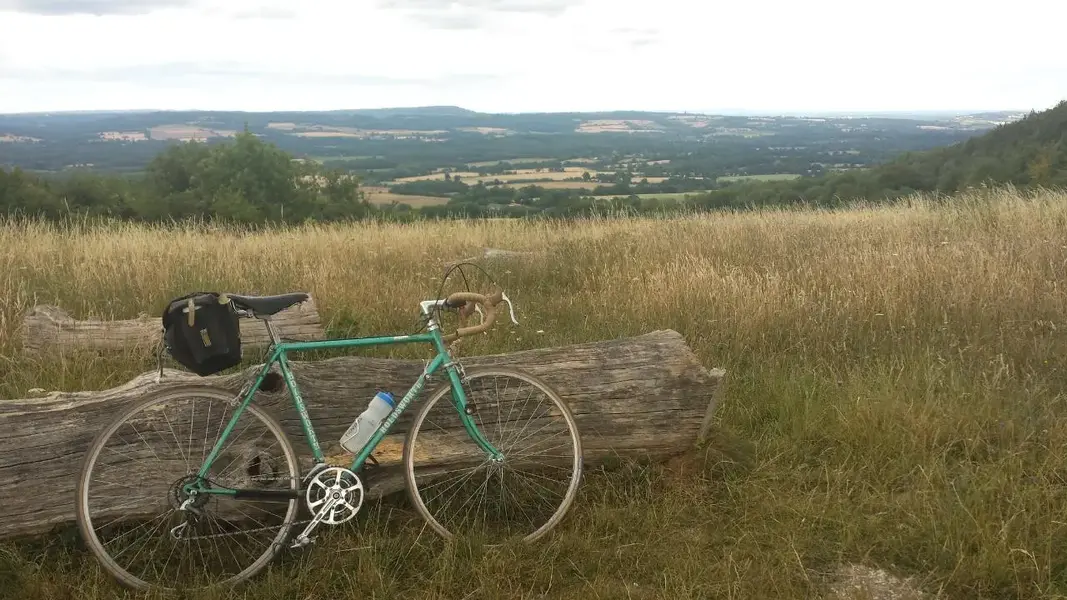

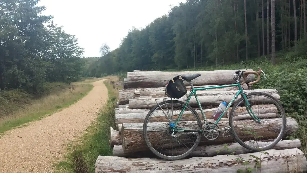

Exactly, I do this on my Holdsworth Mistral when I take it gravel grinding. Switching from 25mm tyres to 37's I have to raise the pads slightly as the wheel move's back. :)
