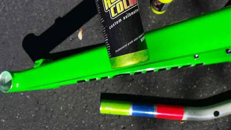

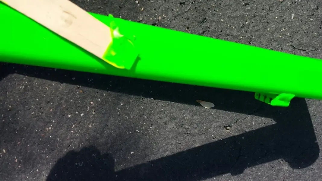

Its brighter than neon Green, it has much more yellow in it. (tough to tell in the pictures but neon green is Too green/dark) I have used a lot of paints from Auto-air Colors, Here you can see some comparisons. the color I came up with (sans the gold pearl yet) was 2:1 neon yellow:neon green.
But its clearly a 2 stage basecoat/clearcoat, the pearl is not separate.

OK SO I figured out the paint, pretty simple actually... Turns out that it is neon green a little bit of gold pearl. yeah I know sounds obvious, but what threw me is that the paint is LIGHTER than regular neon green. So I added some neon yellow, and this got the right shade BUT with out the gold pearl, when I finally got the gold peal it made it even lighter.
So then I tried Neon green only and just added the gold pearl and that was it, the pearl lightened it up a tad. and that was it!

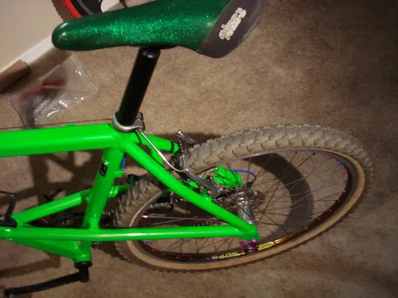

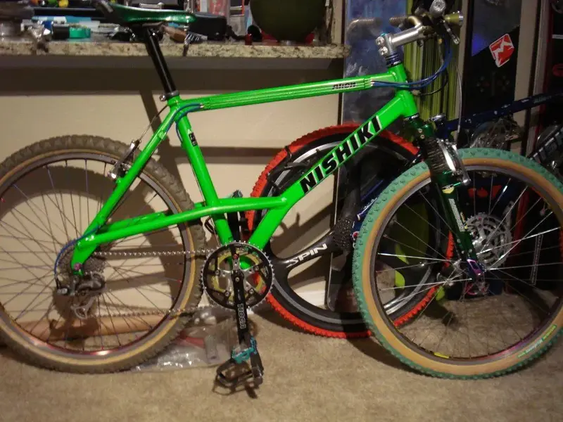

Ok here it is as of today, not exactly where I want it, but Close, sill want the Yellow maguras Early XTR front der, Gold or blue or purple, Seat QR seat collar.
I have a Syncros Ti, seat post but I need the correct shim.
I also Have a New Amber Tioga psycho K tire. debating whether to use it, If I cant find a second one.
OR those Red Hot-S tires you see in the back ground.
so the basic specs as it stands.
XTR shifter, Der, cassette.
Revolver cranks
Machine tech hubs (T-30) Mavic sunset 217s, with Ti-die bladed spokes in the rear, Ti QR's Not sure who makes the skewers, think maybe Curve?
Odessey Svelte Pedals with Ti spindles! (also have a couple pair of Time ATACs one with neon green inserts, and other with brand new blue inserts with Red bearing collars)
Stem is a Answer DH stem One shortest one I could find with a face plate.
Answer Protaper riser bar.
and DH3 Marzocchi of course.

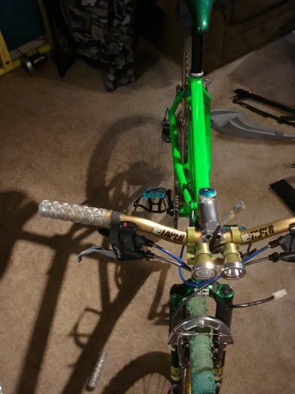

Oh and also you see a set of Custom anodized Turbo Cat Headlights, that I just put a 6v halogen from a NiteRider and a Phillips LED bulb from the hardware store (using a 7.2 RC car pack, makes them brighter)

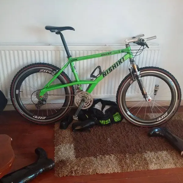

Hi
Thought I would show you my alien that I've been building for the last year or so, luckily it's original paint and in pretty good condition, I have another alien frame which has been refurbed and was painted black so gonna use this one as a colour match, I think I've done a pretty good job, just need to source a decent stem, let me know what you think
