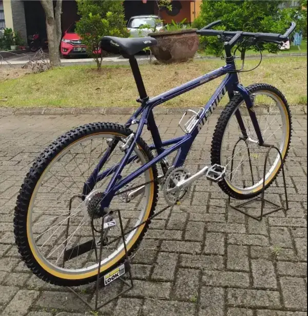

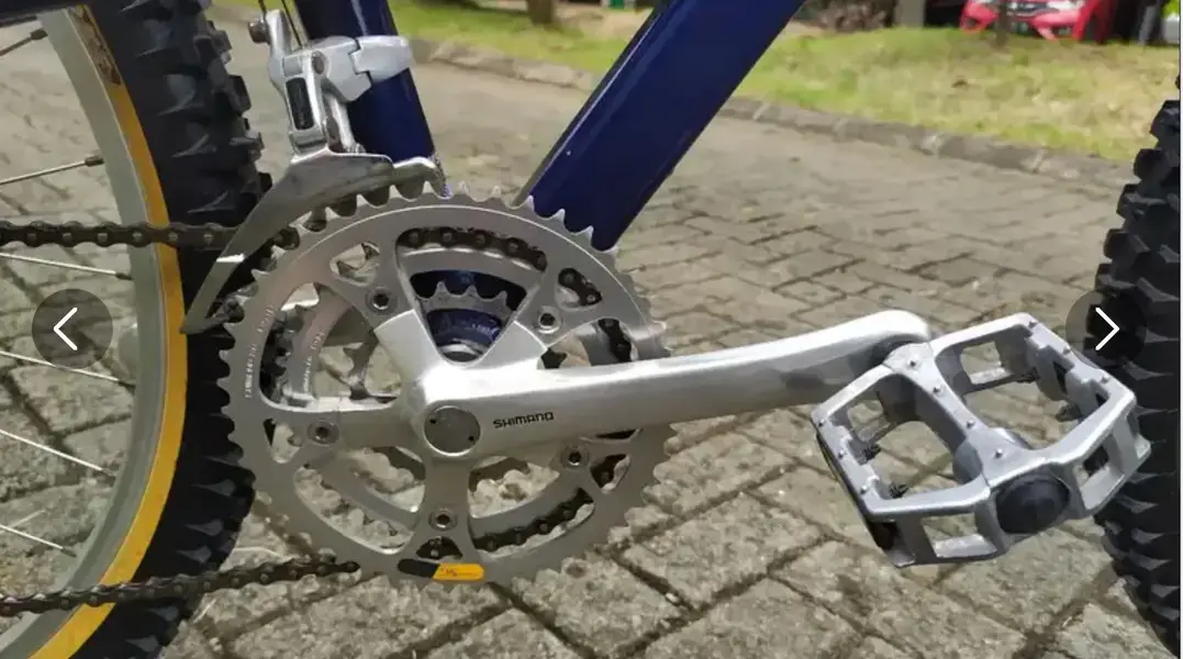

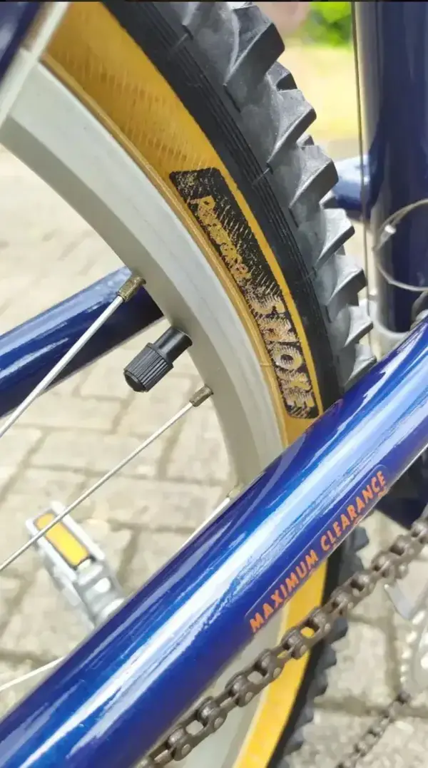

Looks to be all original except for the pedals. Although it's listed as NOS, I see a bit of brake shoe rub on the rear rim.

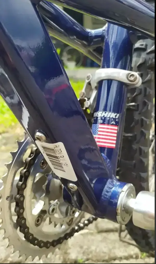

IMHO, such a situation calls for a careful inspection of the frame. In my experience over the past dozen years or so, 90% of these aluminum Aliens (as well as the Alien ACXs) that show up for sale are already cracked (see my rant somewhere on here). When I see one that's this nice, it's almost a sure thing that it cracked early in its life and was parked, hence the almost unused appearance.
At about $1k, however, I think it's a fair value for all the shiny new parts.
