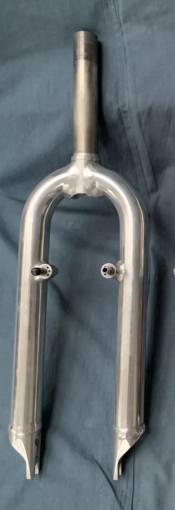

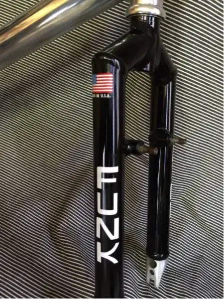

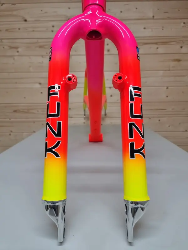

With regards to what we're asking for, well it's a "Funk Fat fork III". The box crown Fat fork cracked, so a unicrown version was made and as far as I can tell that was around from 1992 to 1994. Production numbers were very small as everyone wanted suspension by that point, which is why they're so rare now and command such a high price when they do come up for sale.
As I said at the beginning this might not happen so I'm trying to manage expectations. If we can get over ten, then the onus is (hopefully) on Daryl to come up with the drawings and a price.
No wonder the box crown Fat fork cracked if you build it out of Easton E9 tubes.
I suspect some were and some weren't. Daryl told me a while ago that he used .095" tubing, whereas some of his competitors chose to go with the thinner walled stuff and they had quite a few recalls due to breakages - he thought he had fewer.
