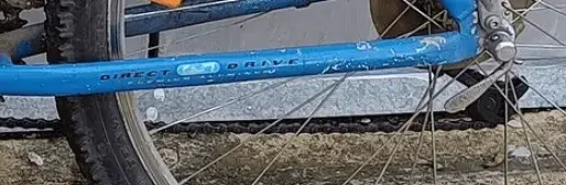

Hm. Says "Direct Drive" on the chainstay. I have a rusty old late-90s rockhopper in the back yard; from what I've been able to gather, "DD" was their brand of chromoly. Forks and frames were cromo, stays were hi-ten
Kind of a tank but seems like it would be a great city bike and an even better art bike. Mine was too badly rusted to do anything with. Too bad, it coulda been a fun project.

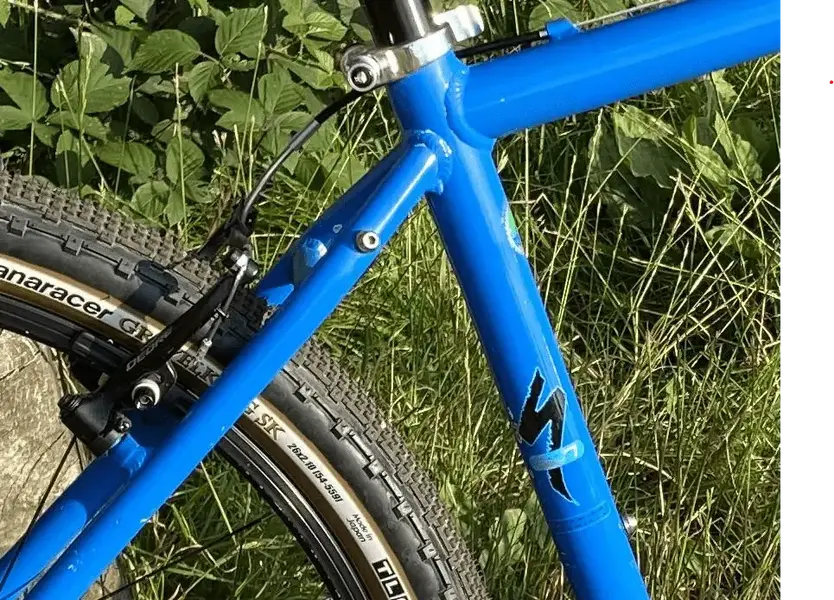

I think the screws were just tightened quite a bit, which leads to cracks in the paint on the mounts, as these are also painted. Over time and due to vibrations, the paint continues to crack, the aluminium corrodes under the paint and the paint flakes off. Not nice, but not tragic.
At least that is my opinion.

Quick question, is there anything I can do now to prevent the corrosion from spreading further and causing more paint to chip off. I'll slacken the boots of for now to help relieve some of the stress.
Thanks for the insight much appreciated

Hmm, I'm not a paint specialist. But I don't think there's much you can do. You can preserve the area with wax and renew it regularly, depending on how often you drive.
If you don't drive on roads covered with salt in winter, it shouldn't spread too quickly. If you do, or if you have other areas where the paint is flaking or blistering, you can either leave it as it is and accept the patina, or have the frame sandblasted and repowdered. In our area this costs around 100€ (plus decals). Or you can do a painting project yourself.

Oh, if there is no paint around the screws anyway, you can tighten them again. It's too late in those places anyway. The mechanical stress only leads to micro-cracks in the paint at the beginning and starts the whole process. You can also observe this on the dropouts and possibly on the bottle cage mounts.

The wax idea is interesting, I think I can possibly improve on it though.
I think I'll using a very mild abrasive on the corrosion and instead of wax try some of that ceramic coating they use for cars. Might give me a years protection on the exposed metal as well as the paint.
Failing that lacquer the frame after cleaning it up and preserve what's there.
It'll come down you how lazy I am feeling on the day 😉
I am guessing but another layer or two of lacquer could stop the micro cracks from spreading.
Have to ask some paint guys I think.
