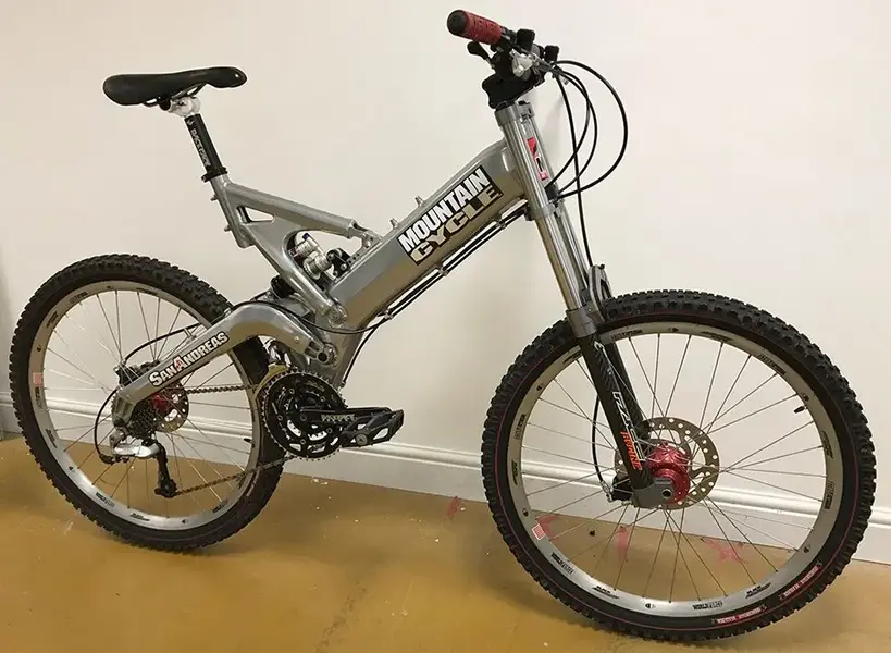

My earlier frame is a chrome finish from factory on all the parts, it's not polished.
Not the best pic. I think a contrast between frame and seat tower/rear would look better.

I see your point. Mine will be like that (very nice by the way), but a bit more red anodised bits such as fork crown, outer ring, pedals. Same hubs though, but with black rims, spokes and red nipples (easy!)
Matt silver and polished alu might be too close. Maybe a darker flatter grey on the main spar. I have both red and grey decals though.
I've a different shock on this one now, and have a set of black 521s on red biguns with red nipples too... which I'm tempted to run.
