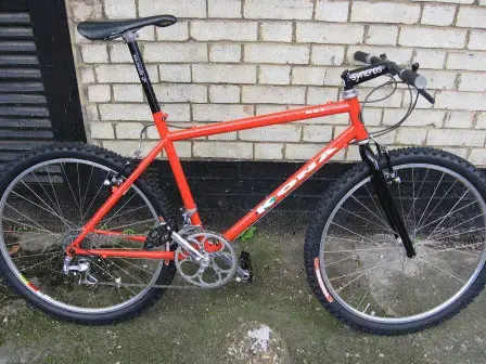

Just bought this from mynchboy.
Its wicked.
And has an ovalised downtube too - its an early one tho - 1991 ish.
It does look like a 1991 and a 1991 Hot has Tange Prestige Concept tubes, with the top and down tubes the same size, ovalised and tapered, 27 x 30 at the back to 30 x 34 at the front.
That's different though to the Columbus Max, which is bi-ovalised, from 36 x 29 to 29 x 36 (top) and 39 x 31 to 31 x 39 (down) (just re-measured them). The Max tubes are thinner though 7-4-7 and 8-5-8, compared to the 9-6-9 on the Concept. I think that makes the Max tubes slightly lighter, but they were quite expensive to make, so not as widely used as Tange Concept, although both are quite rare.
