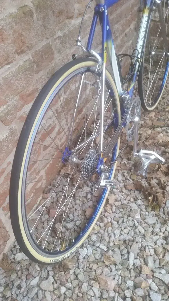

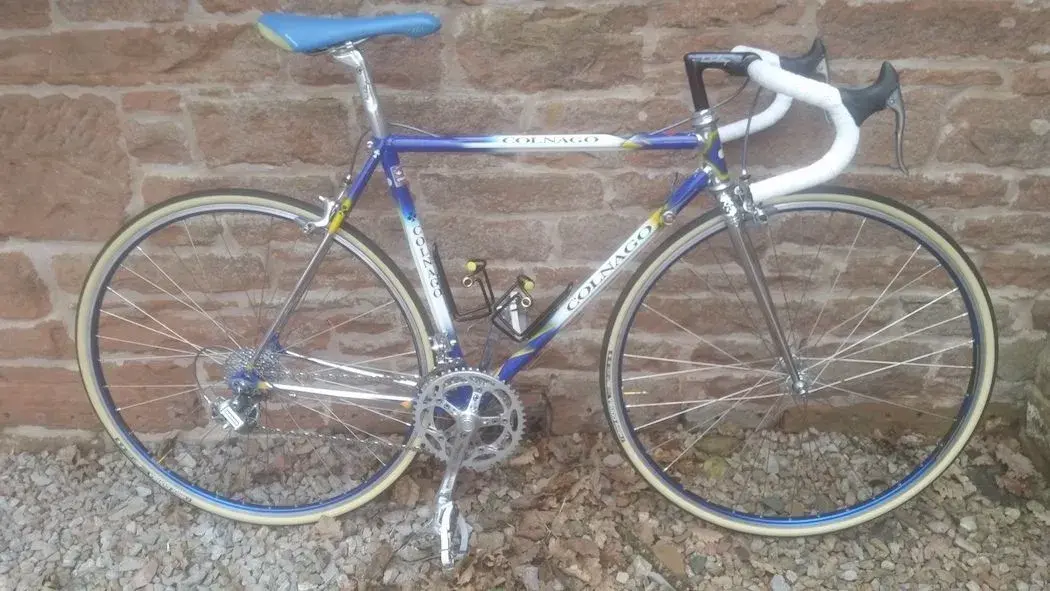

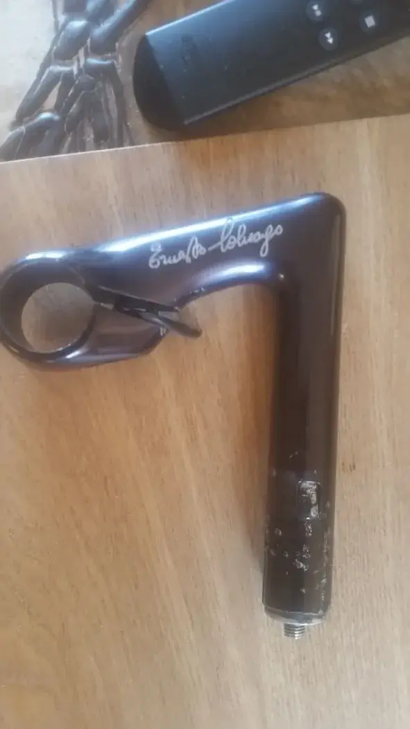

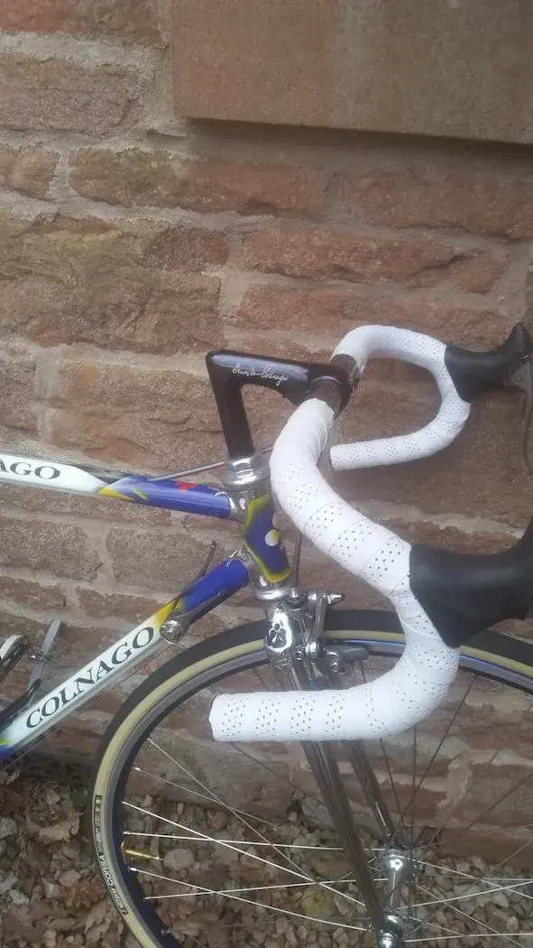

So I've been waiting for another stem to arrive from Italy before I could finish this build, I think it was sent via Australia its taken that long to get here :roll: . I wasn't overly convinced by the Record stem with it being 5mm to long but the biggest niggle it wasn't period correct and didn't suit the build which it the important thing. In the end I went for a 95mm 3ttt podium stem in black but also pantographed Ernesto Colnago.
So with the stem finally getting here on Friday I was keen to get this finished but I'd have to wait until Sunday afternoon to get on the case.
I decided for this to be a rider that I would have to make some changes, the first were the tyres and tubes I went for some 25mm Vittoria Corsa as I've used them before and they really have a good feedback from the road as well as being nice a grippy and as this is never going to be a competition bike I sacrificed a bit of weight for the ease of puncture repair going for the slime tubes.

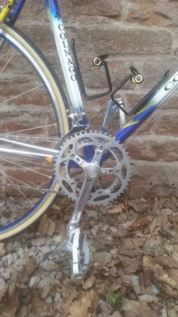

The other choice was the chainrings I'm not a fan of grinding up hills and prefer to spin my way up them hence the choice in the 38t ring size giving me a bottom gear of 35.98 still not as low as todays modern compacts but it will help for sure and a top of 110.32 which is sufficient for my peddling prowess (or lack of it :facepalm: )
Looking forward to taking it out and seeing what the Colnago hype is all about but with the weather front we have coming in thats going to have to wait too. :LOL:
Thanks for looking.
Frame: Colnago Master Piu Columbus Gilco S4
Fork: Colnago Presica
Headset: Dura Ace 7400
Stem: 3ttt Podium
Handlebar: 3ttt competition
Bar Tape: BBB
Brake Levers: Dura ace 7402
Brake Calipers: Dura ace 7402
Brake Pads: Dura ace
Brake Cables: Shimano
Shifters: Dura ace 7402 8speed
Front Derailleur: Dura ace 7402
Rear Derailleur: Dura ace 7402
Derailleur Cables: Clarkes
Cassette: Shimano HG51 12- 28
Chain: KMC 8speed
Cranks: Dura ace 7402
Chainrings: Stronglight Dural 50-38
Bottom Bracket: Dura ace 7400
Pedals: Dura ace 7400
Rims: Ambrosio Exellence 36 hole
Hubs: Dura ace 7402R 7400F
Hub Skewers: Dura ace 7400
Nipples: DT
Spokes: DT competition
Tyres: Vittoria Competition Corsa G+ Graphine 700x25
Tubes: Slime
Saddle: Selle Italia Flight Titanium
Seatpost: Dura ace 7400 aero
Seatpost Binder: generic
Bottle Cage: Cussi Elite
Extras: REG Italia toe straps
Weight: TBC

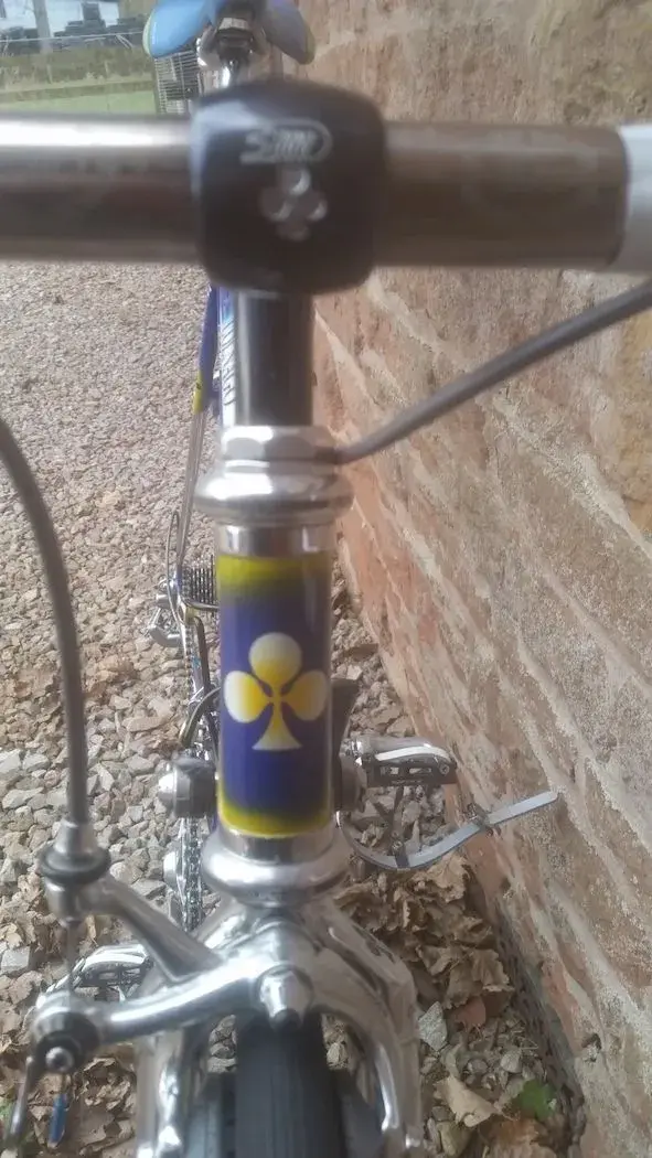

Great bike but... is it safe to have the stem out of the frame that much?
But again: very nice build!
Wim
Brrrr...
If you're a fan of an aggressive riding geo, this is gonna be your bike. I finished rebuilding mine today (as a neo retro) and it definitely is my favourite bike.
