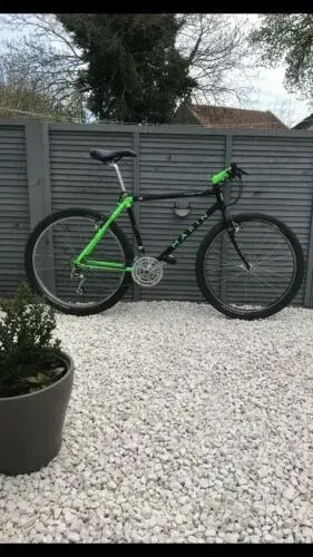

Hi everyone I am new to the group, I have just purchased an old Marin palisades trail (1992 I think) I’m just wondering what options I have available, would something like this be beneficial to fully nut and bolt restore? I’d enjoy doing something like that whilst we are in the Coronavirus lockdown but is it worth just leaving it as it is? It has everything there it could just do with a freshen up etc. Has anyone else had one of these? I picked it up at a good price so have money to spend on the restoration of it if it’s viable.

Looks like it’s pretty original from the pic, but difficult to tell from one picture. Still I would first examine the cables, gears, make sure none of the parts are seized. Grease any bearings. Assess for any play, check brake blocks.. just a general overhaul. Before you know it you will get the retro bug and have a whole stable of bikes! Anyway nice looking bike:)
Looks nice from the picture mate, probably need to see close-ups of the components, pictures.... we love close up pictures & plenty of them!

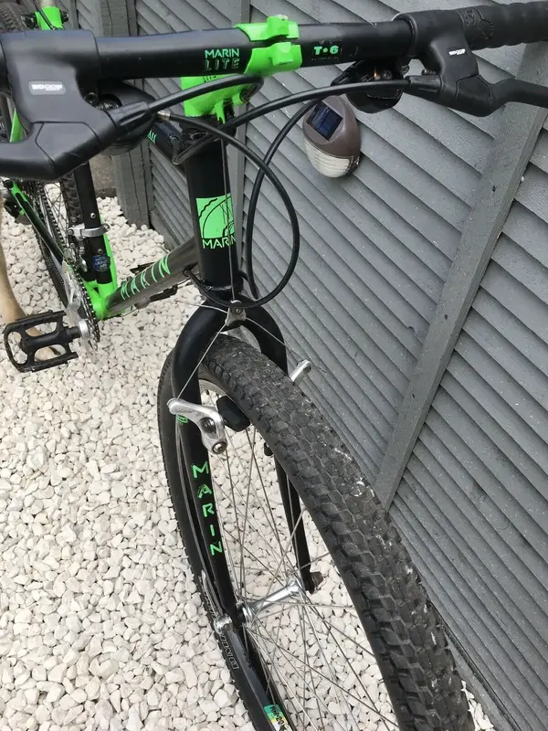

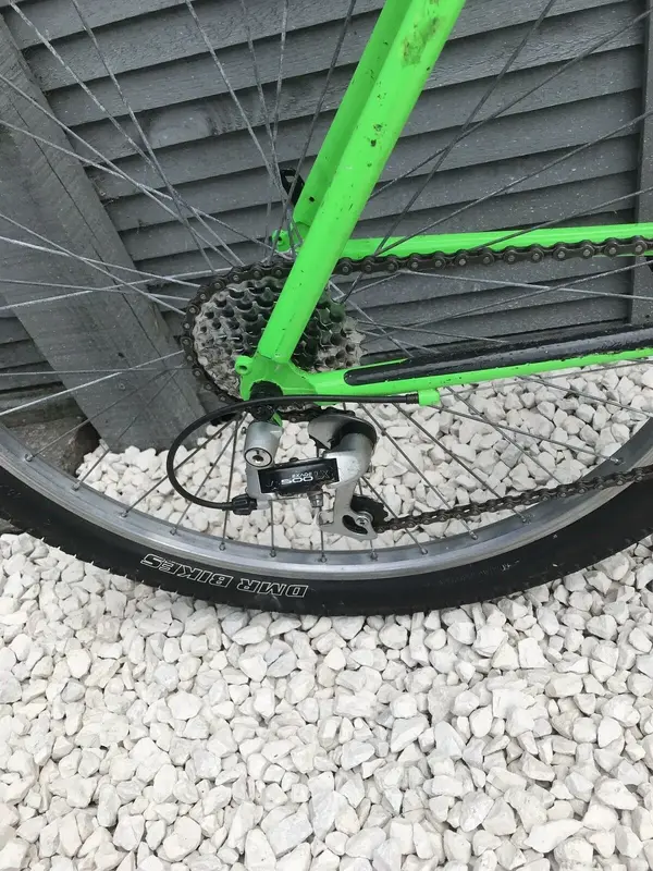

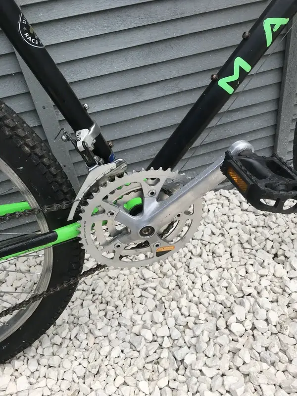

More pics...

Overall looks pretty good and original, minus the original tyres, saddle? The muirwoods was the low end Marin. In terms of group set. I think to a Marin collector maybe 75-100 pounds best. I sold an 1992 Marin Eldridge grade, original spec XT, Dx and in very good condition for £150 as reference. Hope this helps

I had one upto a year or so ago. Mine was in as good a condition as yours.
Nice when the 1992 colour remains, kinda rare as the flouro fades in the sun.
So far all the 'must do' swaps have been done. Chainset anyway.
Check the bottom bracket. If original, it will be shagged, heavy
And rusty LP30 or such like. 122mm axle length for these.
Get a un71, 72 in there.
Brake blocks...if original mt65's I would bang some kool stop or ritchey in there.
Ought to keen-up the braking power.
