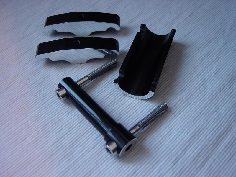

The 7075 bar was converted into these, some for the Marin, some for the Airborne, some for the Fat (oversize), spares and one for Cherrybomb :

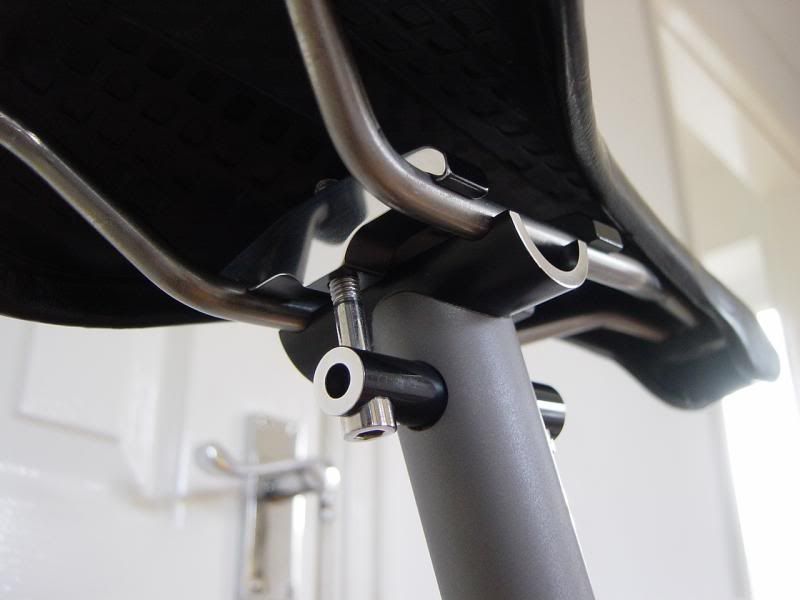

They are for the USE posts, they are my custom design to :
A) Replace lost / missing / hard to source (correctly sized) items.
B) Stop the pin moving rewards and the front bolt head touching / damaging the finish on the front of the post.
C) Add a bit of bling :cool: :LOL:
In keeping with the black / polished finish of the Ringles, I sanded and polished certain parts of them :
They look really nice assembled and fit well, just ignore the greasy finger marks :LOL: :

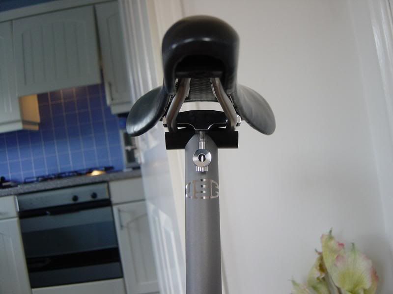

Equal spacing from top of post to both front and back bolts :
Really pleased with the result :cool:
