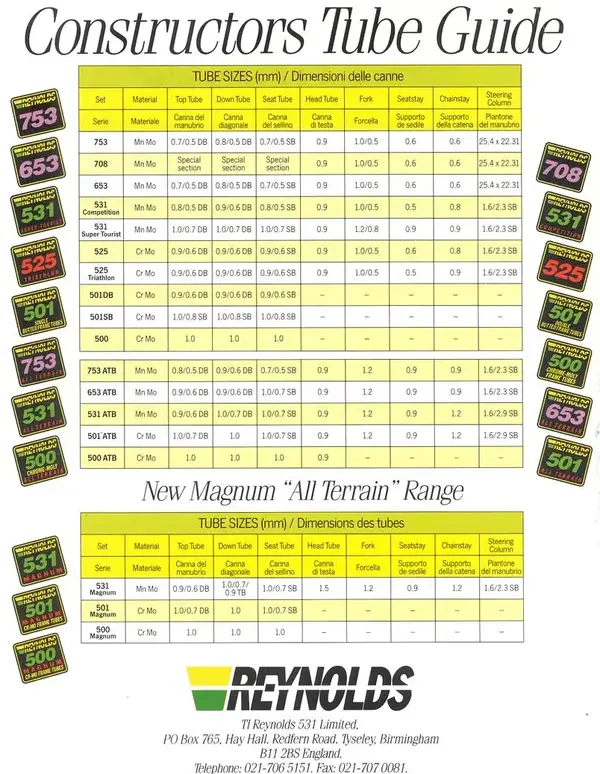

regarding mtb tubes from japan or us or some reynolds . Tubes are not the same for roadbile and mtb , even if they are double or triple , mtb tube are reinforced vitus or reynolds with the same name for road or mtb if you check the tubing size , mtb tube have usually 0.2 to 0.3 thicker than road tubes. regarding brand , marin ,trek , commencal (not sunn very fragile) scott or giant those brands are bullet proof for mid range frame . Again just avoid alloy frame even if they are from those brands
not strictly true as before companies brought out MTB specific tubesets, builders used whatever was to hand be it road or BMX

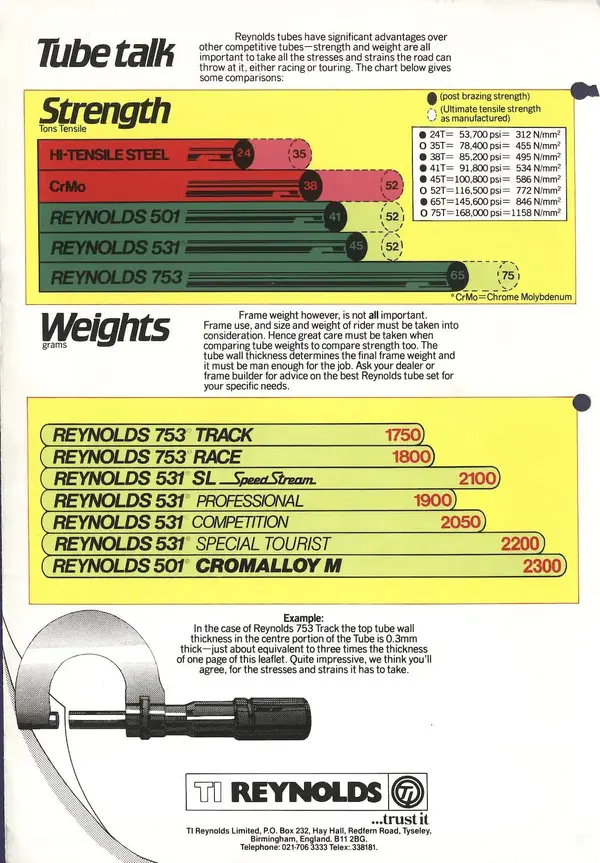

Higher end tubsets are strong. Very strong. And with huge care in the design, specification and fabrication.

El gran queso is right (isn't he always:rolleyes:🤣)- As the old adage goes: Strong. Light. Cheap. Choose two... Getting a high end retro frame means you can get strong & light cheap! As long as it's not been seriously ragged or misused, which is usually fairly apparent, going for the most high-end retro frame makes sense. Just my two-pence worth...
