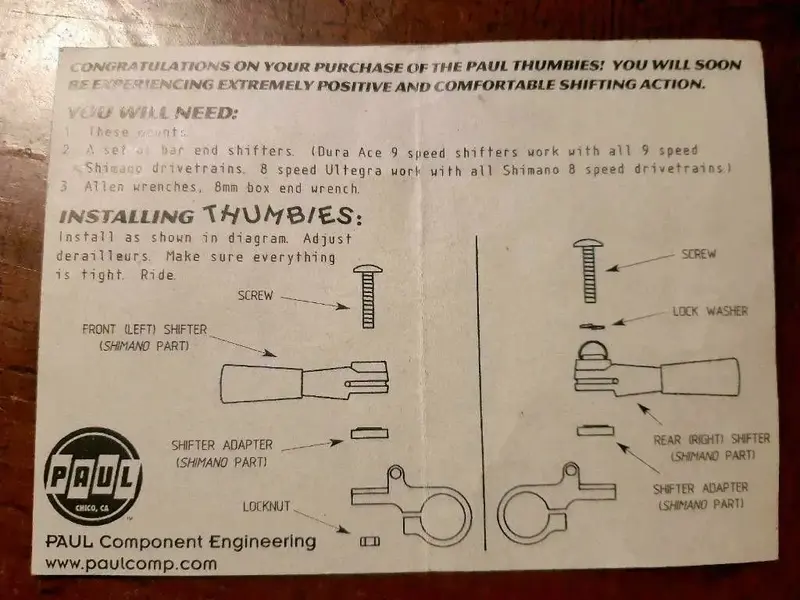

That’s what I’m going to be doing - but these look fantastic - certainly on a different aesthetic level to the Barcons! And much much rarer (and more expensive)
Did the Paul Thumbie/Dura Ace 9-spd setup work on a 3x8 Shimano setup or what? I need details, ahhhhhh! I just ordered the thumbies a few days ago
The picture above shows Dura Ace downtube shifters with the thumbies.
The Paul thumbies, today on his website, says "works with bar end shifters Ultegra SL-BS64"
What is the meat and potatoes? I want the lighter of the two shifters if they both work! Thanks in advance!
