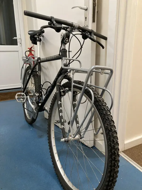

Its not a light bike, ive got rigid Kona's mostly now.. and my main ride has been a last of the steel Explosif with all the posh light bits, so this thing is noticably heavier, but it will be a decent reliable bike, for quite deliberately a slower pace, I can go for a quick fast ride whenever I like ive got those bikes, I am looking forward to getting this out and about.
But I always liked the chrome or nickel finish, all the bits on this suit the frame.

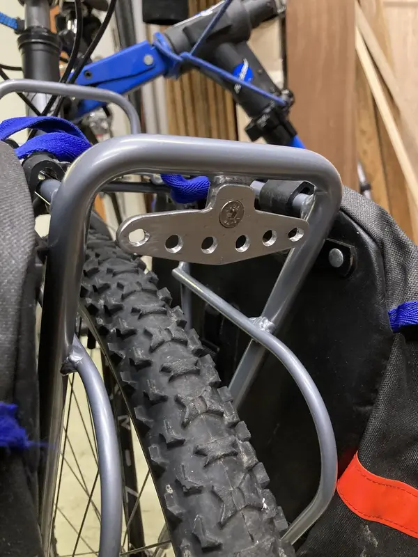

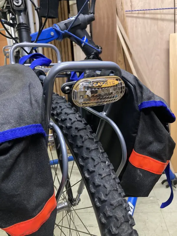

I’ve made brackets out of scrap alloy to make the front rack work, and the front cateye bracket fit…

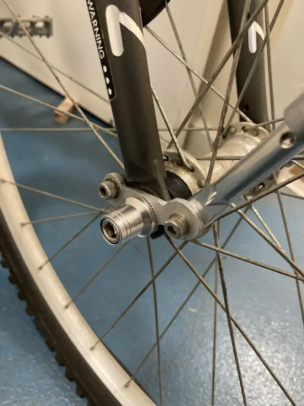

Not everyone will linke the dropout arrangement I suspect but with the security skewers I am happy, it means you need to pull the skewer all the way out to drop the wheel, so no danger of it coming out..! My bracket clears the little tips at the opening of the dropout, and sets the rack at a good height so it clears the cables nicely.
I am glad of this as the rear rack was a mile away and a fiver , and I spent ages researching to get a front one that looks matching..! Very sad but in good company here?
I finally found it and it was in the janurary sale!
But it’s designed for eyelets out front of the dropout.

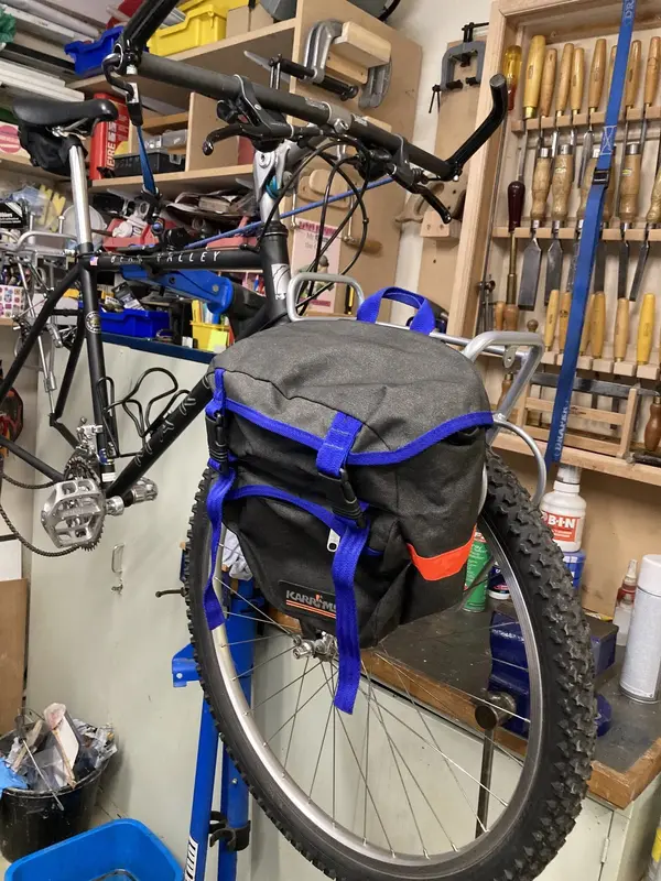

I’ve got those lovely karrimor barely used panniers and I am praying to find a full set of matching or some back ones to match these.
If anyone happens upon this and has them lingering let me know.
I may try a wanted ad… I hate green but black, blue, purple all available when new.
These are proper karrimor from the bikes vintage.
Off topic I have a collection of period rucksacks from Karrimor because they are so nicely made, I’ve many of them so I will be patient and get panniers too!
