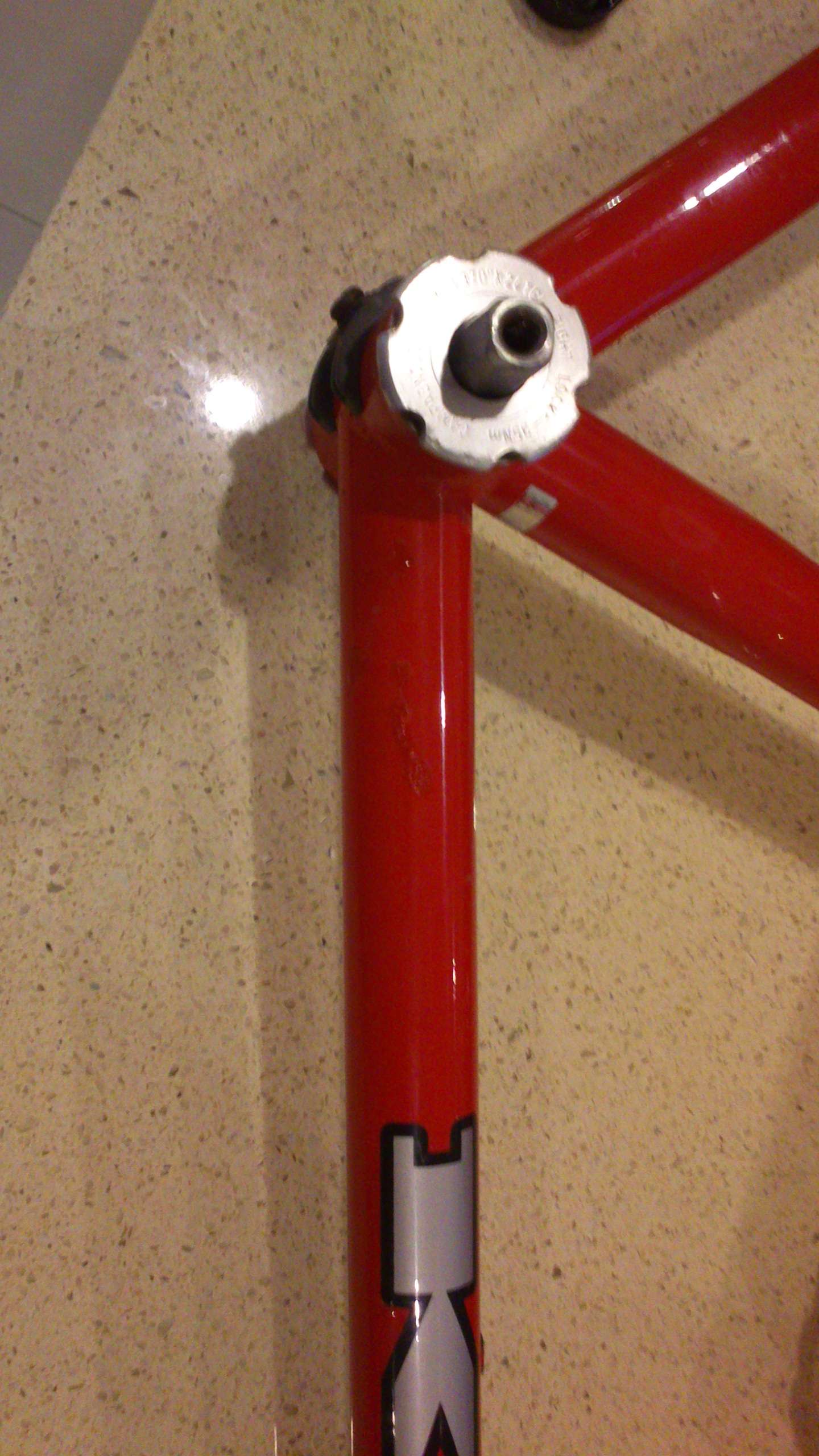

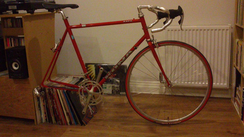

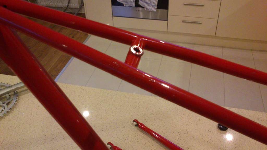

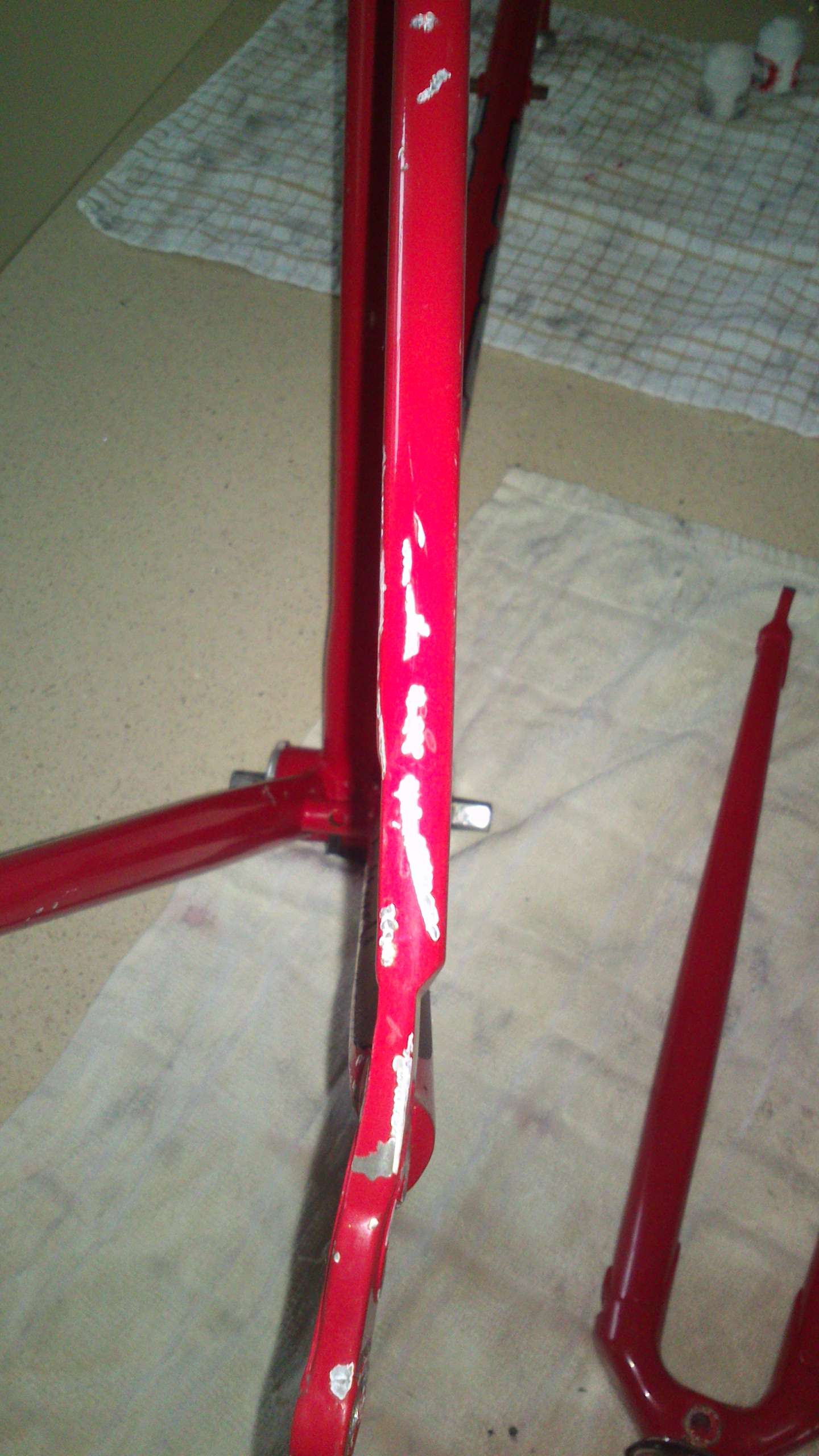

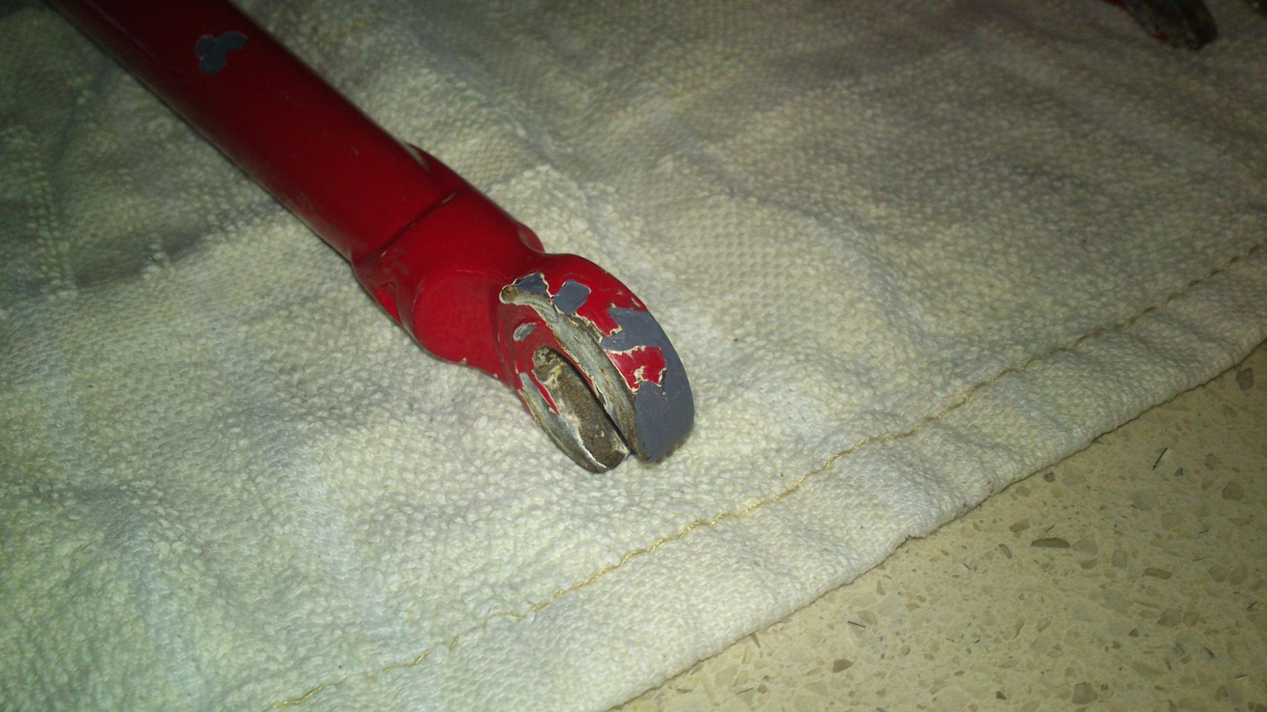

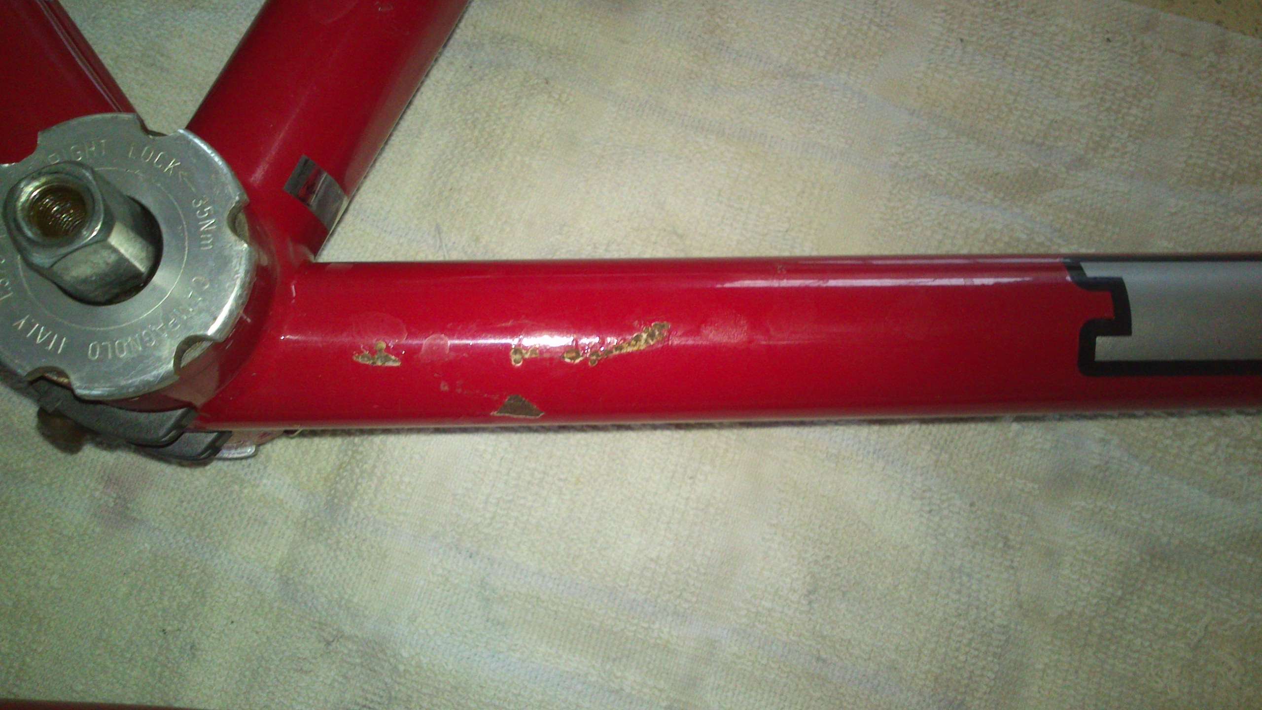

So I cleaned up the frame and forks this weekend. The colour is more of a blood red than the paprika red that the earlier, slightly oily shots showed which is cool. As you can see there's a fair amount of patina. Nothing that can't be resolved with some careful touching up (oooo er).
Sadly my local model shop has gone bust so I popped into Warhammer. Jesus Christ, it's not changed since I was a teen when I had a brief flirtation with painting orcs and things before realising that it was sad, sad geeky, not sad, cool geeky like Tamiya models. That said the staff were helpful and the paints are as hard-wearing as before. I have a two reds, a grey some white, black and clear lacquer.
A base coat of grey was applied to the various bits and pieces, then the darker red. That's already made a big difference. I just need to apply the lighter red before a coat of lacquer. Of course they will never match exactly but, as mentioned, it'll look a lot better.

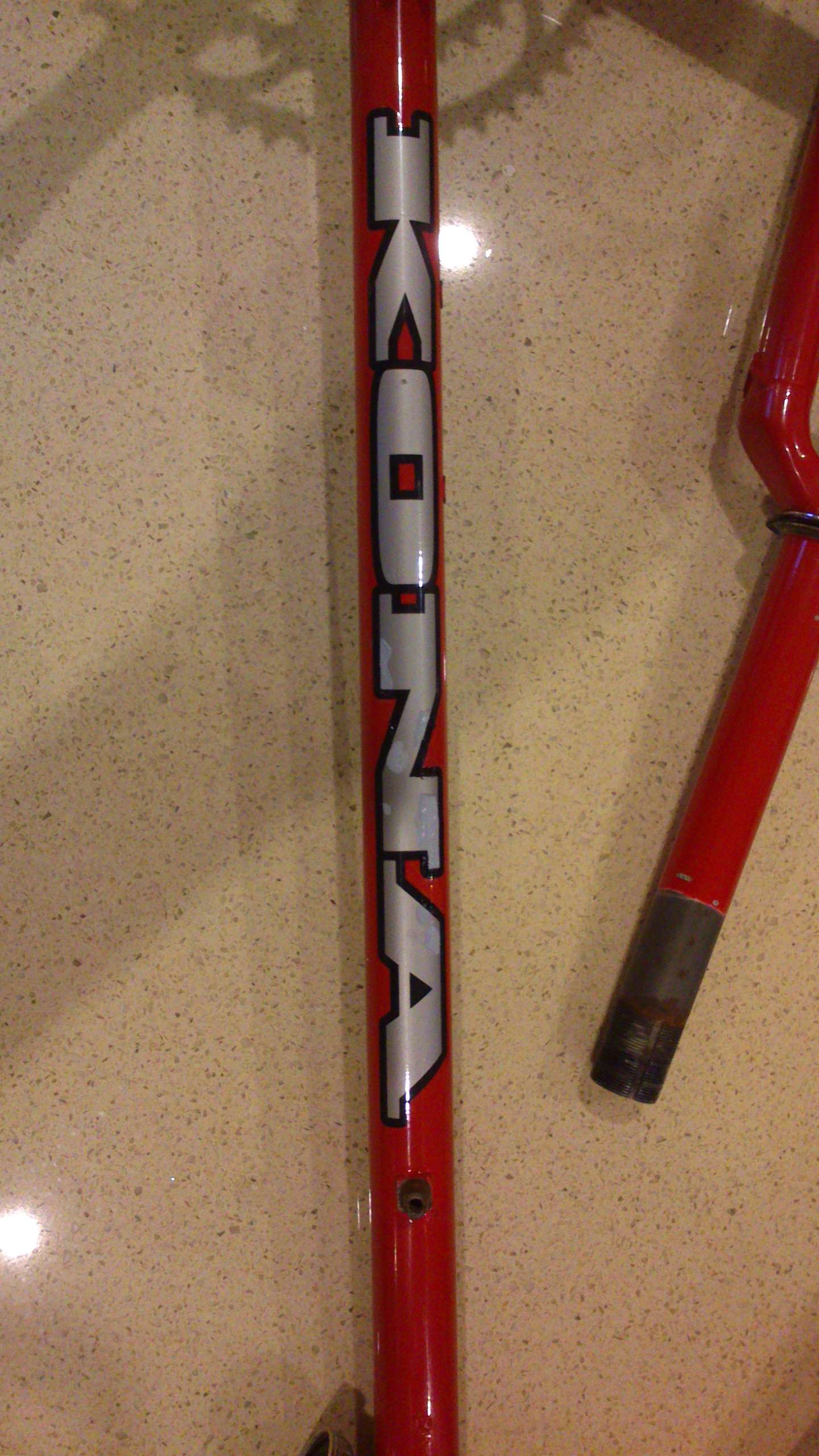

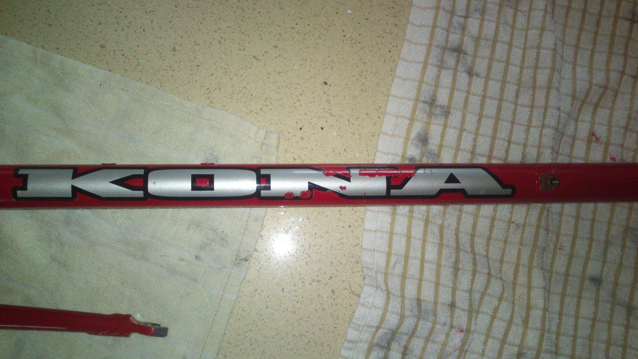

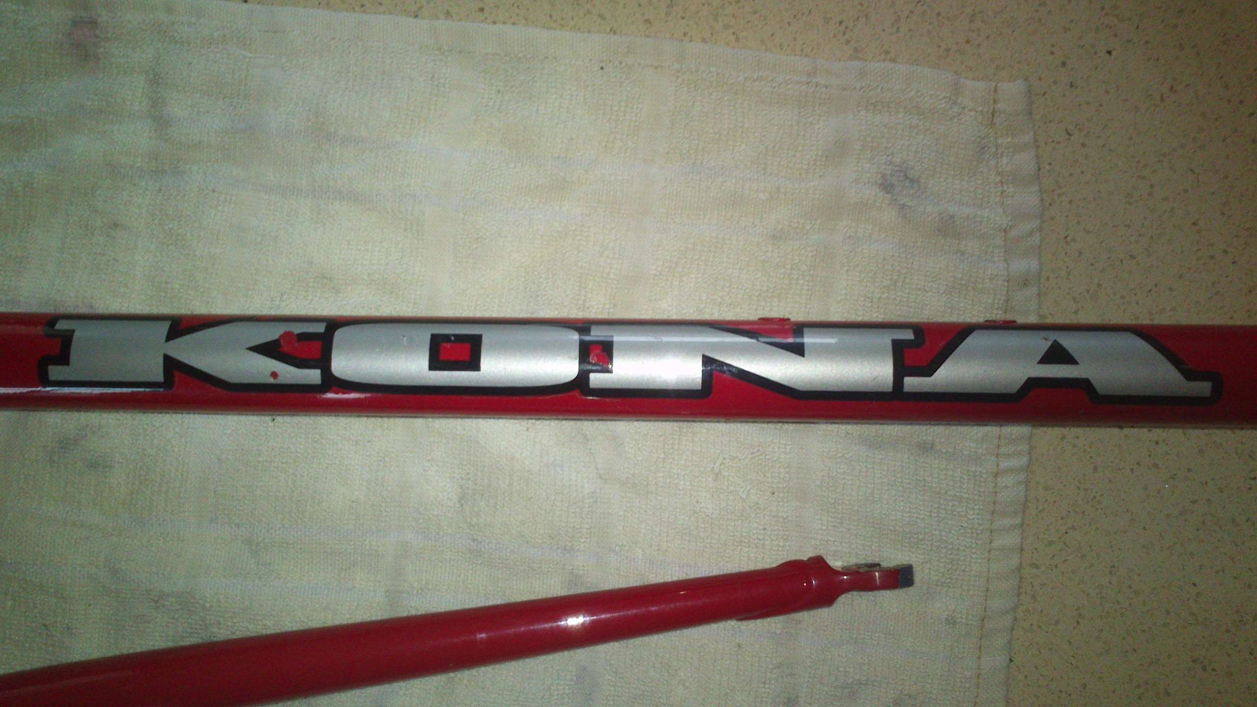

Another top tip. To remove the edges of flaking decals, borrow your other half's cuticle scissors! Super sharp tiny blades with a a curved edge, mean they are great for trimming without damaging the frame or paint.
Decal damage.
Worst bit of the patina.
Check out the fluted seat-tube :)
Base coat applied.

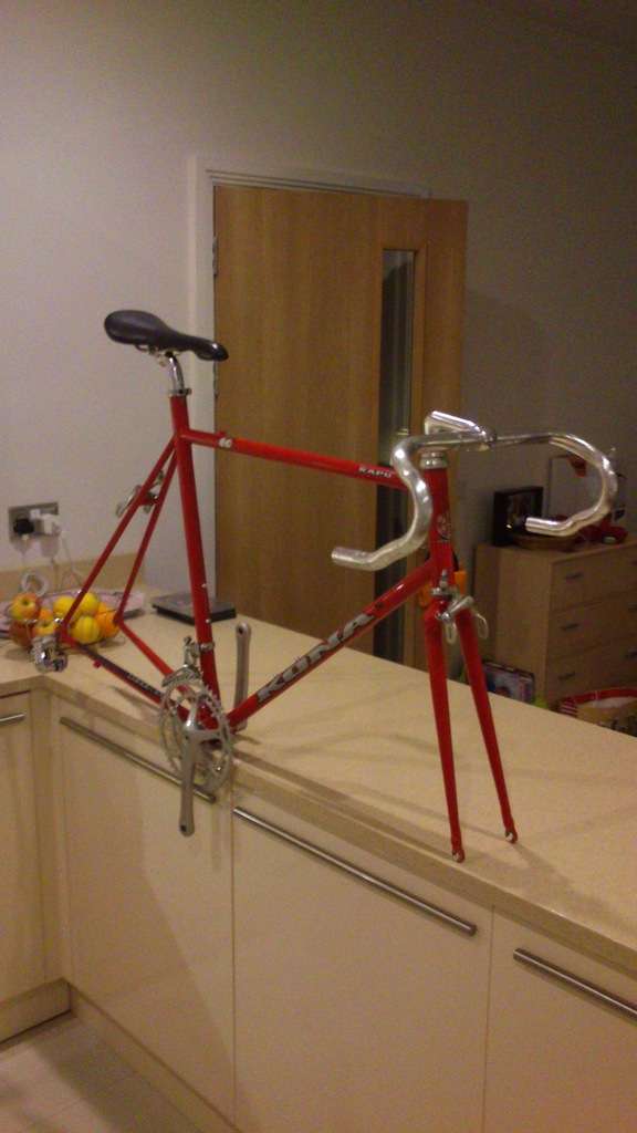

A fair bit of progress over Christmas and the new year. Lots of painting and polishing. The touch up's are good on the red frame and so-so on the grey decals (fine on the black). From a distance you'd never know, it's up close under eye and the camera that you begin to notice but it's still a hell of a lot better than it was before (and match much better than new decals).
I managed to sort out the shifting issues, it was pure filth as usual and after a good clean and lube they are fine. Still clunky but that's the design and function by the looks of it, not the condition. New down tube cable adjusters were needed as they are rusted solid into the housing. New brake pads and shoes were purchased too. Couldn't resist Campy to keep the theme going.
The biggest remaining challenge is reconstructing the free-wheel and axle assembly. To say it's fiddly would be an understatement and not helped by a ever so slightly worn set of adjusting bolts. Ideally a new axle set would be great but where you find one of those that will fit the freewheel is beyond me so I'll give it a good go before looking at alternatives.
Re: Kona Kapu 1994 - epic unicorn (update P3)
We're getting there. New brake shoes, pads and NOS Campy downtube barrel adjusters all on and a very nice, good quality Columbus Genius decal. Whilst it may not have worn one back then, it is that tubing and I think it deserves to tell the world that! Apologies for the poor picture quality. Just the wheels to rebuild before cabling up with the bar-tape.
