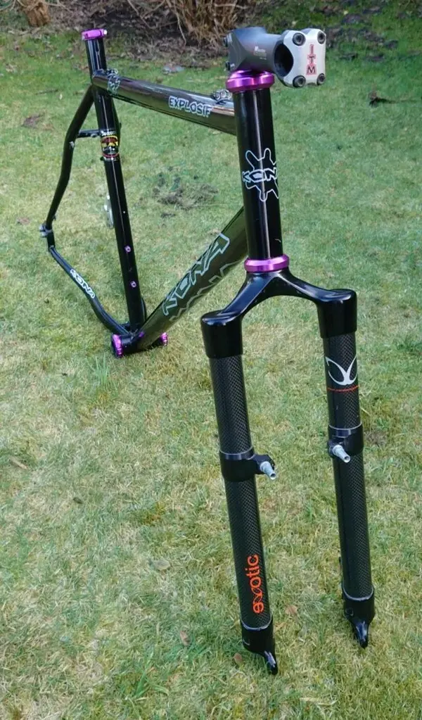

Yay! Quick trip to stand outside the @rideandrepair workshop this morning means the threads in the BB shell should now be playing by the rules. Once I thaw out it's off to the shed to get building.
But first, time for a brew and a Jaffa cake!
Looking good Rick.
Sorry I couldn't let you into the workshop while I chased your BB threads.
This pesky global pandemic does place limitations on my preferred levels of hospitality.
No worries Paul, at least the sun was shining!
So, I don't like the stem but it's quite a low / short clamp, and since the steerer is cut to length any other of my spares is only about half on the steerer. So I'll stick with it for now and pretend it matches.

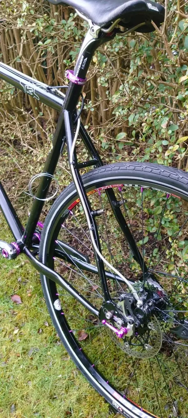

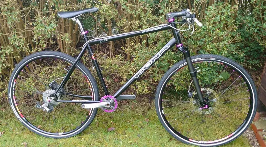

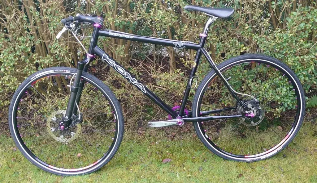

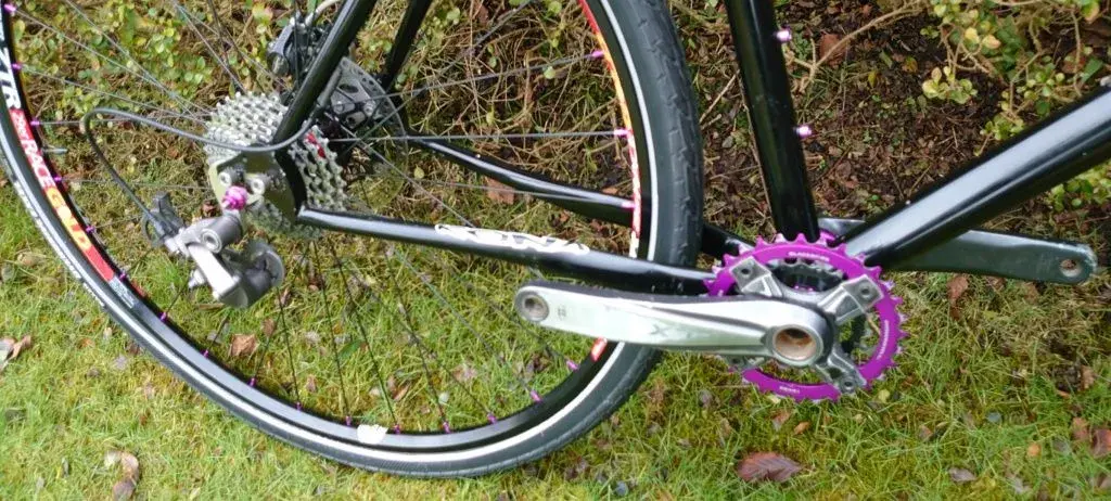

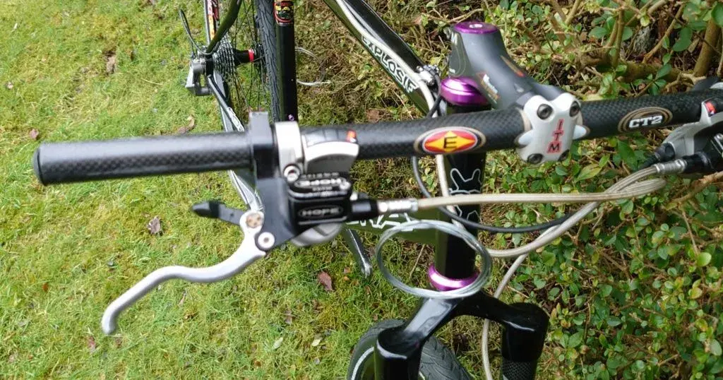

Progress so far.
Used the existing bars stem post and saddle. Pulled the hope mono brakes from the b17 and some floating black rotors. Braided hoses are annoying me a little I think I'll swap them out for black if I find some. XT shifters and an old XTR mech for the back. Used the purple 32 middle ring and added a black 22 ring but am lacking a larger for the outer so that's on my little list so I can run triple, double will do for the short term and I might add in a bashing for now.
Need to dig out some gear cable outer to run to the rear mech, shim for the front mech then I can sort the chain. Taken the old 9 speed cassette from the b17 so I'll use that chain too. Fitted the Maxxis tyres which need a bit of fettling as they are not quite seated right.

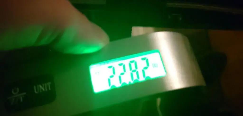

Nearly there. Just needs pedals and setting up (waiting for daylight and above zero temperatures for that job!) but thought I'd do a quick weigh in. Looking like a we'll come in about 10.5 kilo / 23 lb, which ain't too bad.
