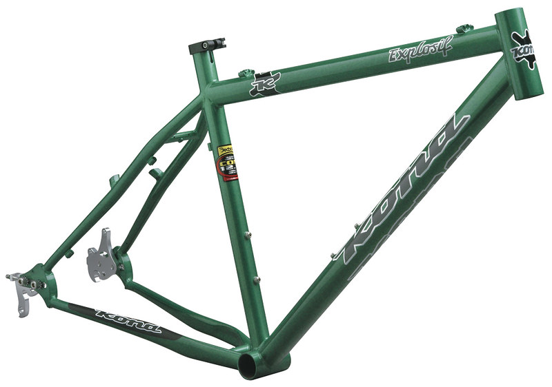

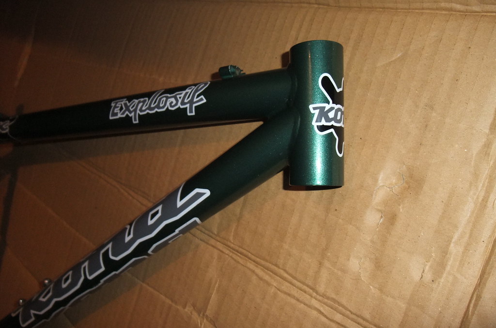

After some rooting around, and trying to find something which a) was a decent light-ish frame, b) with a similar ride / proportions to the RSP and the Voodoo and c) was Green, (or in need of a repaint...) and preferably d) Disc-compatible, I was browsing the forums one day and found a metallic Green 16" Explosif (the very smallest size frame I can ride on a 400mm post - but does make it very chuckable!) from Ruben in Holland in VERY good condition, with swappable droputs! Discs ahoy!
Even better, a decent-quality, steel Kona - perfect match for the handling and not a tank with a bit of luck! Even better, the decals are a match for other component choices ;)
Now, I know that these particular Konas are to no-one's taste.. but in that respect, who cares - it's mine now!! :twisted:

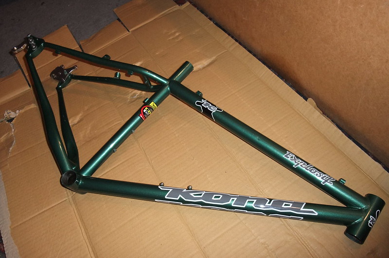

Two weeks later, and last Friday I picked up - my Explosif! (also my first Kona.. )
And set to work..

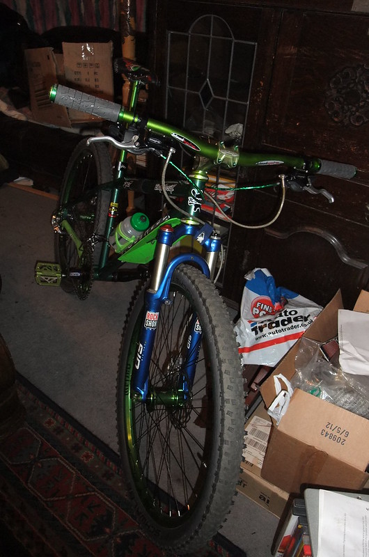

I have yet to find a good set of Green forks. It's a possibility but for now it's Metallic Blue 80mm SID Races - Fantastic and reliable forks. Grey Schwalbe tyres in the right type & condition took a while to source. Next to useless in wet mud, but good in everything else.

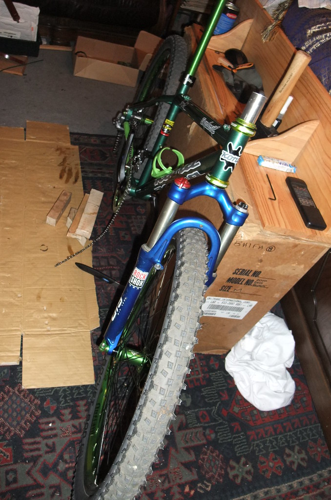

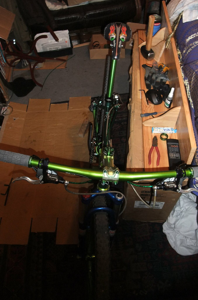

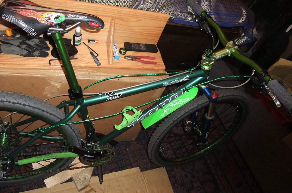

Mocking up steerer & seatpost length.. Have a couple of spacers on top at the moment, but loathe to cut the steerer in case the forks are required anywhere else! Troy Lee Flite saddle was a real find! Love those eyeballs.. :shock: Still don't like the shade of the bottle cage, but it will do until I can find something more appropriate.

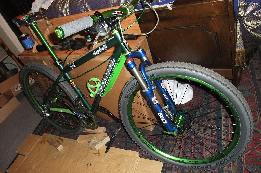

Fitting stem & bars. Managed to grab a Hope team green stem to (supposedly) match the team green skewers & compliment the brakes - but it appears to be a slightly more yellow shade than the skewers, so may see if I can change for a 90mm, it all depends whether the steering feels a bit slow. Bars are Blackspire and match the wheels, seatpost & pedals - nice & wide!
The metallic green cable outers are a bit of an extravagance! But love them too! One problem was the continuous cable routing of the On-One didn't really help on the Kona... Nor did a lack of brake-hose clips.. :x Eventually bodged a fix slightly by clipping in the hose and then clipping the front mech cable to the brake hose. Hose is braided and then coated, and the green gear cable outers are brake outers by design, so will stand up to it - as well as weather and the general abuse of time!

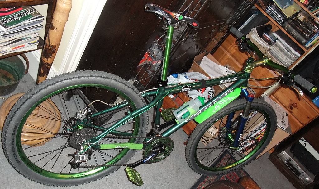

A better idea of the matchup of grips to tyres & decals, and wheels, bars, seatpost, saddle & the effect of almost everything being metallic/pearlescent in some way!
It needs a wash & polish up - & I do need some sunlight (which has been impossible to find since Saturday!) to really show off the paintwork & the metallics..
The somewhat mish-mash of colours may not be to all tastes, however with all of the metal Green components being metallic green there is no consistent colour/shade in any case, and the overall effect is quite substantially psychedelic - which was the entire point! The depth of the blue in the forks I find actually compliments the shade of the frame as well, which I like. Also a bonus was the Grey of the decals being an exact match for the Schwalbe tyres and grips all being in Grey.
Needs a bit of a tidy up on the brake hose, purely functional for now, but rideable nonetheless.. ;) In need of a tweak here & there and some adjustments to the fork pressures, but the main problem is the shorter stays giving too much chain slack now (either that or I simply didn't notice it before on the black frame!). So an excuse to swap out the mech for a long-cage, rather than just using what I had previously. Ah well, needs must! :xmas-cool:

Dont cut the steerer locjs qyite short as it is. I do worry when i see that much post showibg.
Yeeess... Lot of post - actually haven't got it fully right yet.. I've been using the post for 6 months on & off though, and although there's 300mm visible there's another 100mm in the frame (plus I'm no Clydesdale yet..). It may break eventually, it may not, but it gives me plenty of room to drop & a nice low CoG ;)
