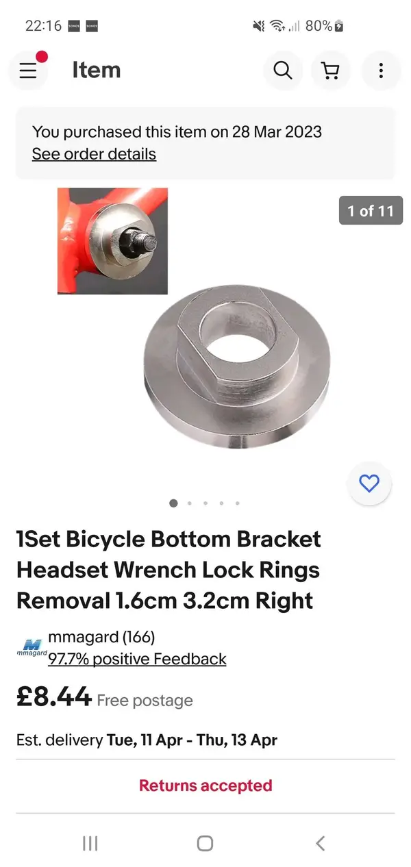

Had a further go this evening without success so did a bit of googling and bought this Screenshot_20230328_221612_eBay.jpg
You can clamp it on via the square taper and should give me better leverage. The frame is currently drive side down with WD40 soaking so I'll report back once I get the tool
